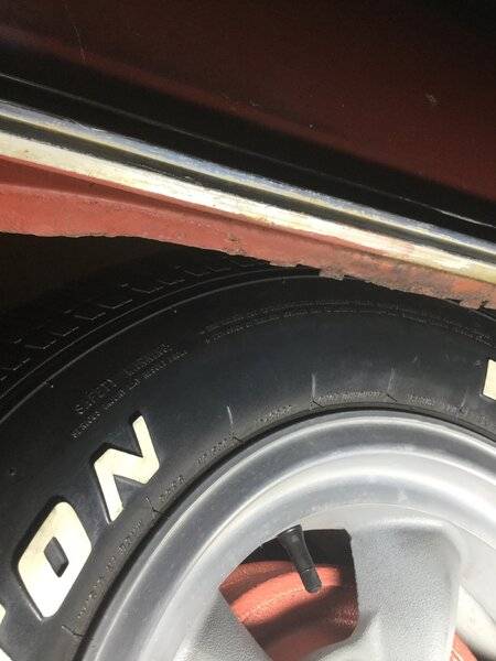

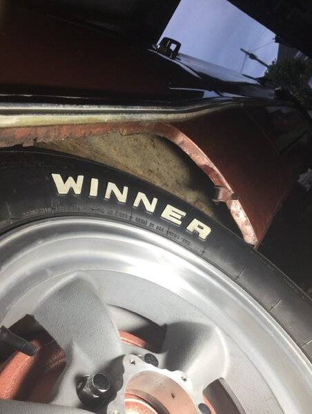

Really? That’s a problem then. I have a pair of 14 x 6 rims I’ve offered up and that leaves 2.25” between the tyre edge and the arch. Using 9” 235 wide tyres.
Pics make it look tighter than it is.
