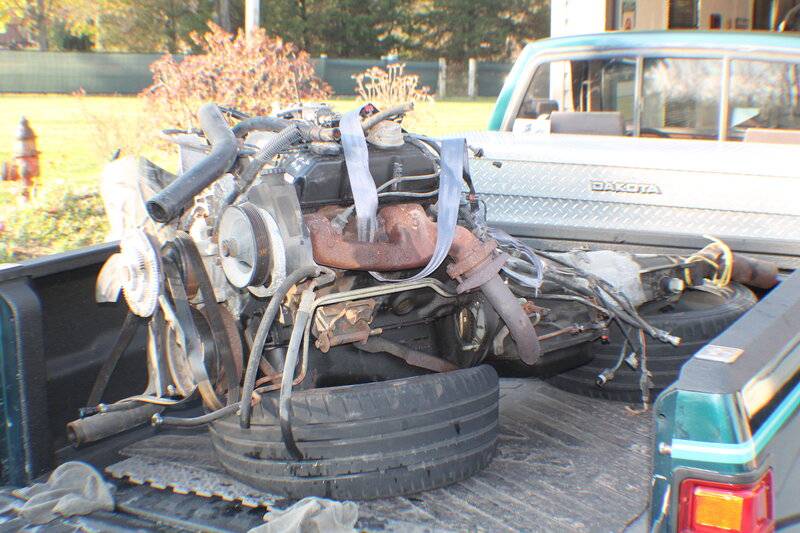

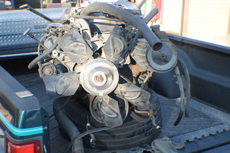

Spent two days in the local yard getting this puppy out.
PITA but well worth it.
3.9 and tranny for $349.
Showed 151K on the odometer and recent trans service at 136K.
Just did a comp test 180-182 on all 6.
Looks like you got a good one.
Too bad I scrapped mine a few years back. No-one was interested in it.
I would probably put a new timing chain on it. If you get the newer one from mopar it has a tensioner built into it.
Re-seal the intake would be a good idea as well. That's definately a design weak point on those.
Those exhuast manifolds look pretty clean.

Looks like a goodie. Check the timing chain before you use it but that's much easier to do out of the vehicle. Those are good mills. I have 2 96 Dakota's with 3.9's 300,000 miles between the two.
Re the intake. Get the intake plenum kit from Hughes and never have to fix it again.
+1 on the chain.
What model year engine is it? Later models eliminated the egr and return fuel line.
If I still had a a 3.9 Dak and suspected an impending failure, I believe I'd consider a 5.2 transplant.
Almost 100 HP gain and only 2 MPG loss.
That's what I did, but it was probably more like 4-5 MPG. I also put in a 46rh. Very happy with it.
