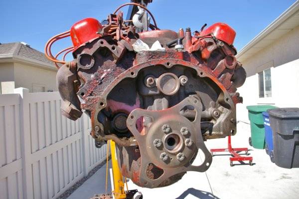

You're on the right track. Here's another photo; you can see the flexplate still attached to the crankshaft.
You're on the right track. Here's another photo; you can see the flexplate still attached the the crankshaft.View attachment 561617
OK I get it this is extremely helpful!!!! So one last question that did not get answered previously. When I start to separate the engine from trans will I need to rotate the flex-plate to get the 4 bolts out or will I be able to get in there and do it?
You will have to rotate the engine. Not with the key or ignition. Just rotate it by hand.
