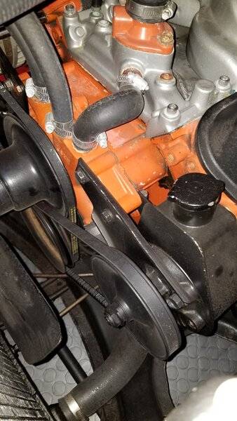

I bought this car a few months ago. 66 Charger. No one knows much about the engine other than it's a 318. I'm in the process of timing and I'm a little confused if the tab is in the right spot. Check out the photos and let me know it's a little confusing

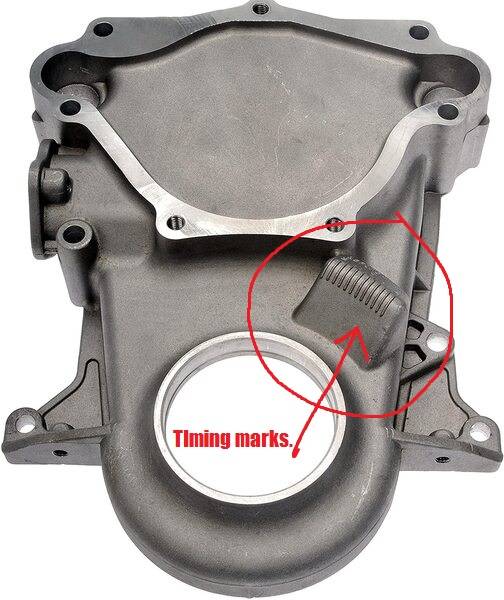

Are you referring to the timing indicator plate/location?

The timing indicator in the op's picture shows the location of a 60's 318. The indicator is bolted onto the water pump on the passenger side. The later picture posted by beepbeepRR shows a later design. Not sure when it switched.
Correct I believe - my 318 is poly and indicator bolts on. OP says he has a '66 so not sure if it would be later or a poly...my guess is poly.

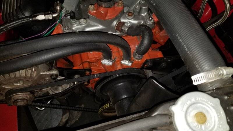

Could it be a poly timing cover with later heads? I included a pic of the head and they are not poly heads for sure.

I want to say 1969 was the change in LA timing cover indicator location but I'm sure someone else knows for sure.
OP's pic is for sure NOT a poly, and therefore not the original engine in a 1966 Charger...not that it really matters.
Yep - can't mistake poly heads...right around 66 poly's ended. I had to obtain a new timing cover for my poly and from what I gathered if memory serves, the later teen's cover was not a fit so located a poly cover to replace it. Don't know if it's possible some 66 cars had poly's or LA's depending on prod dates or not - stranger things have happened.
