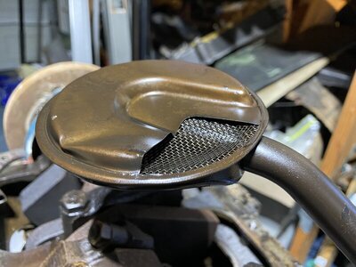

318 oil starved from day 1 —oil pickup damage
10:03 PM
Aug 24, 2021
21
4
Texas
There is no oil pan damage, so this could have limited the oil supply right out of the gate. So far, only a bent push rod.
It's possible that the pump still pushed plenty of oil and the engine never knew the difference.
I have a hard time believing that that damaged pickup had anything to do with it.
You can pour sand into a 318 and it will eat it for lunch. How was the oil pressure?
I think look elsewhere.
Yup, I agree with everyone, that likely wouldn't hurt anything...
