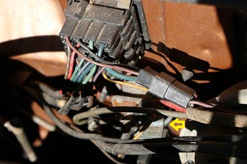

Usually connected (between) the the neutral safety switch stud and the bulkhead connector.
Thanks for the reply 451 Not sure where the neutral safety switch stud is is that for a manual trans?
On my '69 Coronet it is on the firewall near the bulkhead connector.
OK thanks will check in that area!!
I think I posted a photo a few months back, but can't find the thread in the search?

Just recalled, the photo is still on the camera SD card:
Thanks 451 for taking the time to reply AND the photo. Looks like the grey wire the arrow is pointing to even says fusible link lol. Bubba did something to possibly this wire yikes. So I am still investigating this. Look like the fusible link is a stand alone wire and not part of the main positive wire harness. The picture does not show the actual location but it looks like its basically a jumper type of wire fuse from one bulkhead connection to another?
Lol looks like Bubba strikes again! He repaired the fusible link with electrical tape which is why I had a hard time finding it lol. Will Bubba wonders ever cease to amaze me or at least entertain you guys lol.
