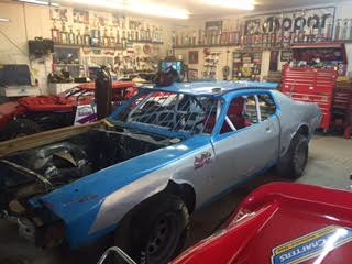

Finally took a picture of her for you guys. That's not going to be the final color, thinking about sublime green with a black hood.
