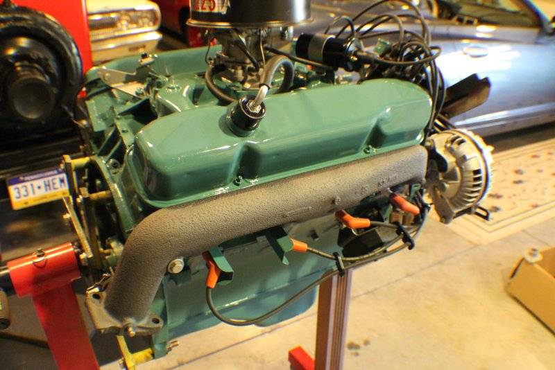

I recently found out that my 1959 361 BB has a extended crank and will not accommodate a manual transmission. Machine shop had to modify their engine stand to work on it.
Totally rebuilt and ready to install. Brewers said I am not the first to try this application, he said it will not work and there are no known adaptors.

Yes. I believe you will be money and time ahead if you swap in a later model 361 crank or even a 383 (with balancing the rotating assembly).

Yes you are screwed on any trans newer than 1962. The crank flange is the problem, the back of the block is the same, so are the mount ears, but it takes disc type core plugs.
Need to swap the crank. If you have the balance sheet from the builder then you know rod and piston weights and you don’t have to take it all apart.

Swap the crank, it’s not that big of a deal. The rest of the engine is just fine.

Any 62 up 361 crank would be perfect. The 383 crank is dimensionally identical but, the bob weight would be higher to accommodate the heavier piston/ring assy. That may require rebalancing the rotating assy.
