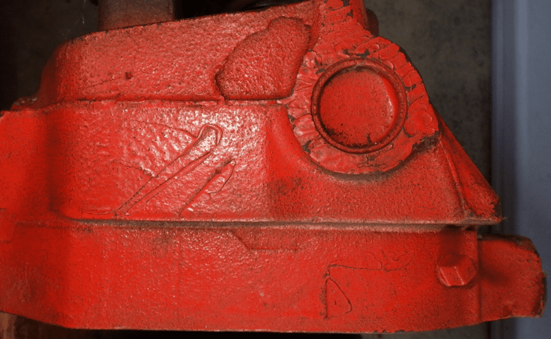

One of the heads has what appears to be a Heli-coil insert. It's located at the rear facing the firewall.
It's on a 70 383.
Must be on the drivers side. Of no real concern, was probably a stripped and repaired alt most bolt hole.
It's on a 70 383.
Ok. On a 50 year old casting no doubt a little acceptable repair was made. What is your concern????????????????
You lucky devil. Not everyone will get a Heli-coil there during their lifetime.
Lol, how many get a pipe plug...............
I’m not sure what the purpose of the hole is where the pipe plug is, but it’s factory.
I’ve seen it in that exact place on a number of different heads.
....I’ve seen it in that exact place on a number of different heads.
I was thinking it was a casting issue such as porosity/void causing a pin leak. The plug might be the fix to save the casting. Lol, although I'm curious, I'm not going to remove it!
The first time I saw it I thought the same thing.
Then when I had a pair of heads come in where both of them had the exact same thing...... I figured it’s done for some other reason.
I’ve probably had a dozen heads like that come through the shop....... various casting numbers....... plug is always right in that spot.

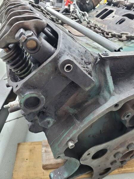

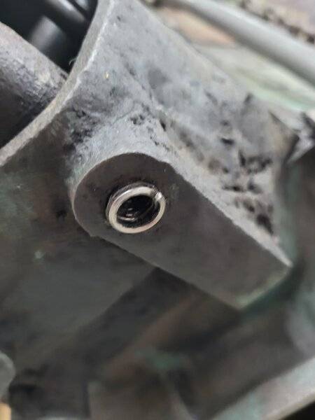

Sorry to take me so long to post pics
Thanks
Whoever installed it didn’t thread it deep enough. I usually thread them at least one turn past the top. You could pull it out with needle nose pliers, run an STI tap in to clean it and install a new one.
That head might have been on the right side at one time and the hole was stripped as it was used for a bracket or alternator bolt.
It's poorly installed. It can be redone..... but if you aren't using that hole for anything on the backside, why bother?
