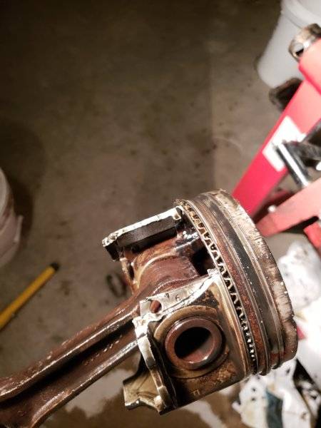

In the middle of a tear down on my 383 after breaking a skirt on cylinder 4. Found out piston selection is pretty scarce for the 383. Ended up ordering the kb400s which is a 6cc dome to try and bump compression. This is what I plan on running:

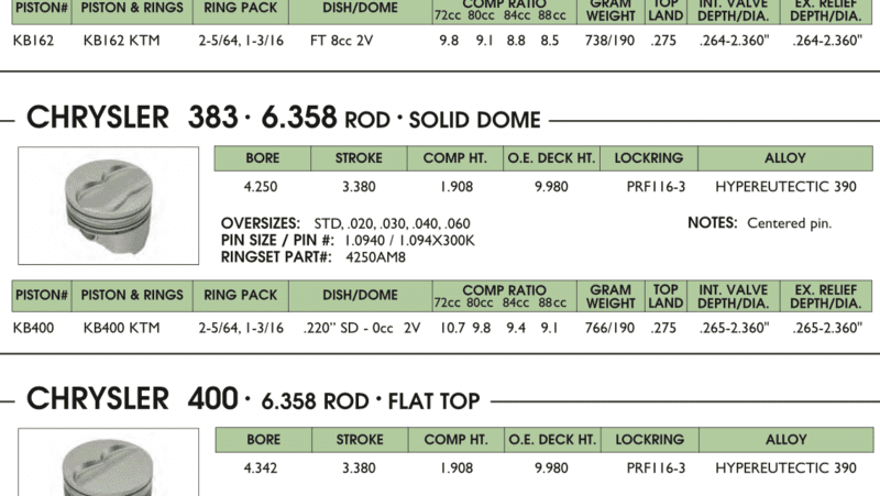

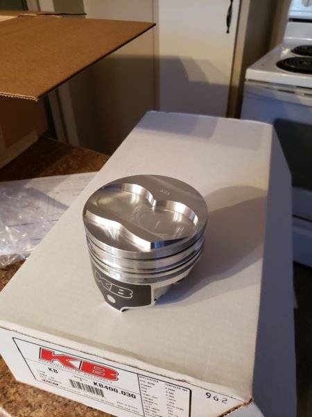

I’m curious if that box of pistons in the pic says they’re a 6cc dome, and whether or not those are current stock.
Both my old 2016 catalog and the on line catalog show the KB400 to have a net 0cc effective dome volume.
Noticed that. Maybe the dome is 6 cc, and the valves reliefs are -6 cc, netting zero.
From what I understood the effective volume of the valve reliefs and dome equals 0cc. The dome itself is 6cc
