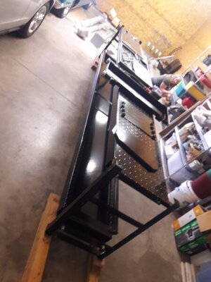

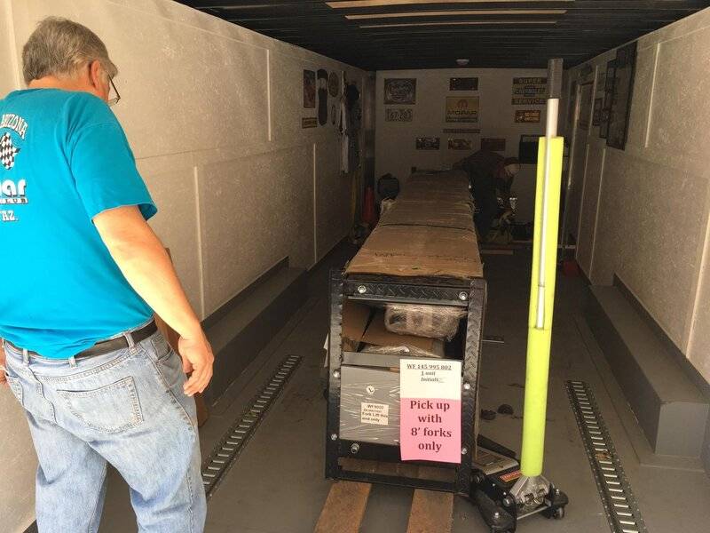

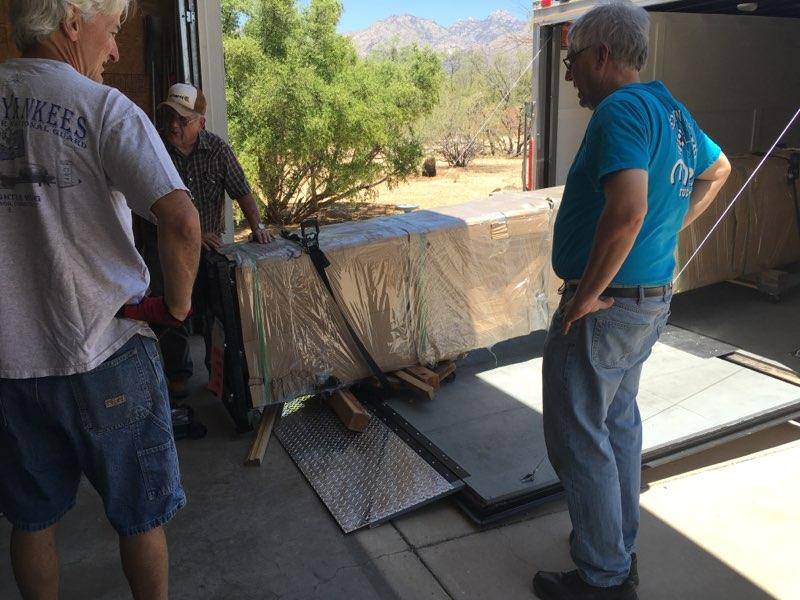

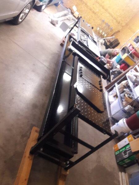

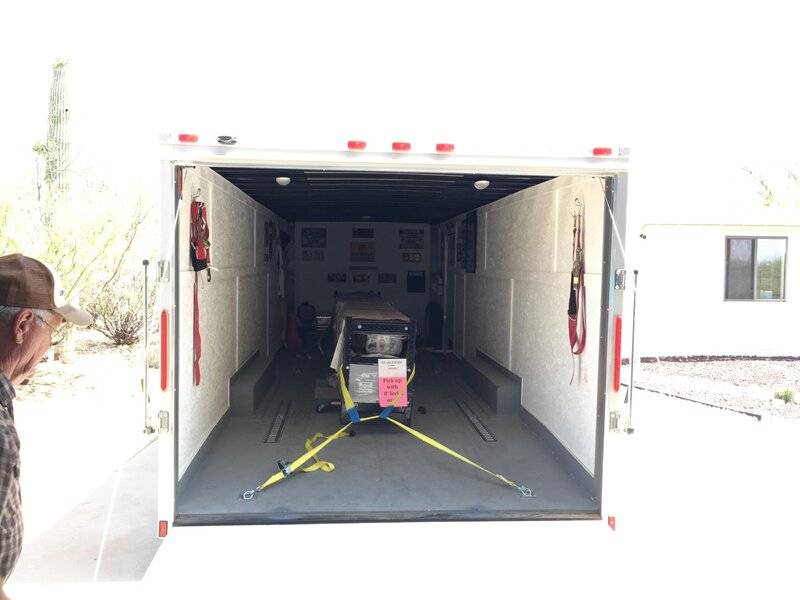

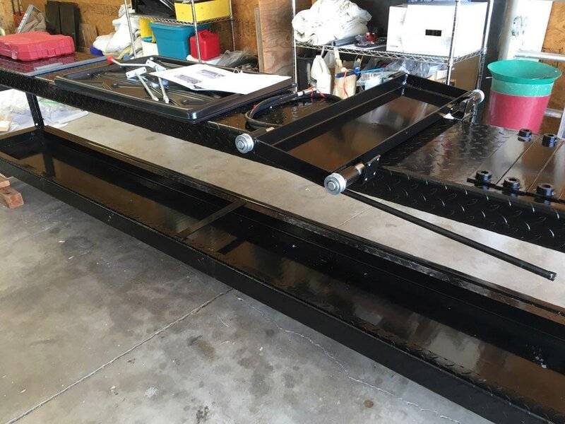

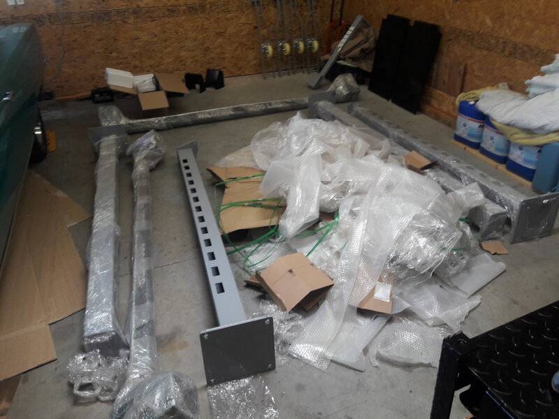

Well I'm in process of assembly. Loading it was a breeze, but unloading was quite a bit of work. One of the harbor freight 1000lbs dolly wheels shattered, and it took finesse, a floor jack, 4 guys, and a bunch of 2x4s to get it off the trailer. It's unpacked and in position. Next Friday I'll borrow a engine hoist and we will assemble.

I was lucky. My lift was in pieces due to my move. Made it easier but I did have a friend help me get the ramps out of the trailer. I put it together using my floor jacks, old t-bar for leverage, moving dollies and grunt. I asked the friend to help me assemble some of it but he didn't show. Was not about to pay $1600 to assemble when I paid $500 to disassemble.
I unloaded and assembled mine by myself with the use of an engine hoist and floor jack. Manageable, just be careful.

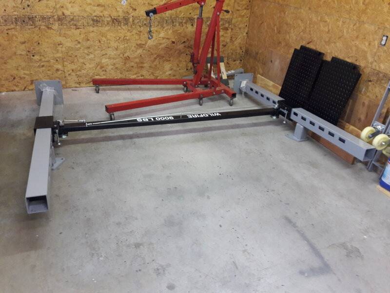

Friend dropped off his hoist. I rearranged all the posts myself and built the front. Starting to look like a lift. Off for a handful of ibuprofen. Friday we will convene and try to build this thing.

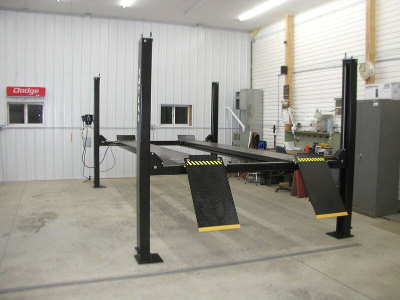

Well, I knew somebody was going to ask this eventually. I don't profess that the brand/model lift I purchased is the best lift, it just was what worked for me. Everyone is different and has different needs. My biggest objection to that Wildfire lift was the fixed locking system, along with the light weight that I didn't mention. As I recall it was only about 2100 lbs shipping weight?
I purchased an Atlas Apex 9 for my shop, shipping weight about 3000 lbs. So right off the bat there's about 900 lbs more "meat" in the thing somewhere, don't know what components are heavier, but something sure is. Also the design has adjustable "lock ladders" on each post to compensate for uneven concrete floors. Just two differences that to me make a big difference.

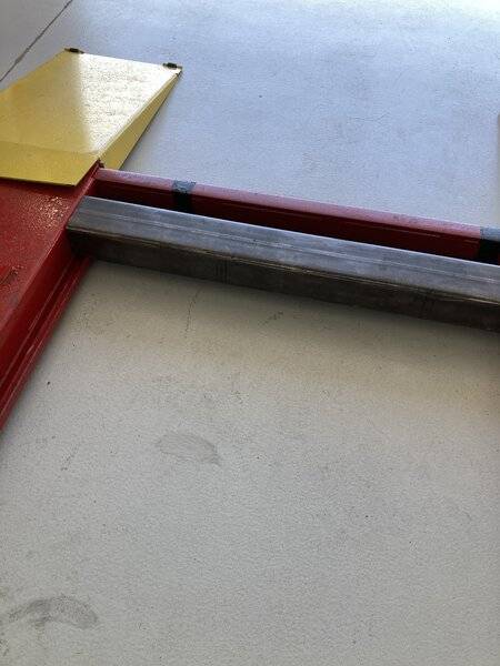

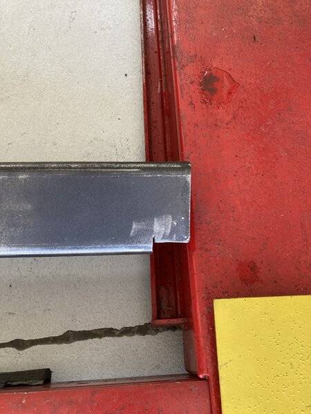

Something I made up for mine which would be handy for others. I got ahold of some 4x5 rectangle tube to make some crossbeams that fit between the ramps. With these I can put some wood under an area after lifting with the rolling jack, set it down on the wood then move the jack to a different area.

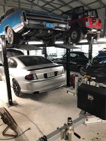

I've got a Danmar and an Eagle in my toybox. Paid a grand a piece used. You can do quite abit on them and both have jacking plates.
