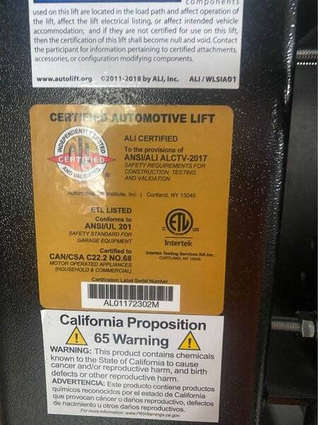

I’m currently looking at a PP8P Direct Lift. It’s a little over $3500 if I pick it up from the warehouse which is less than an hour away.
Direct Lift is the "home" version of Rotary Lift. Both made in the same facility... both certified..

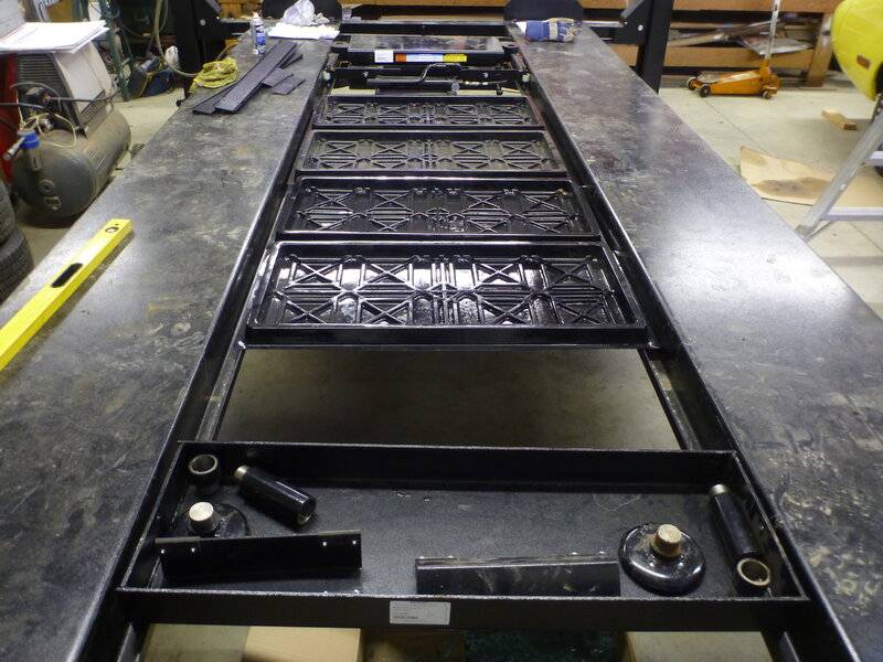

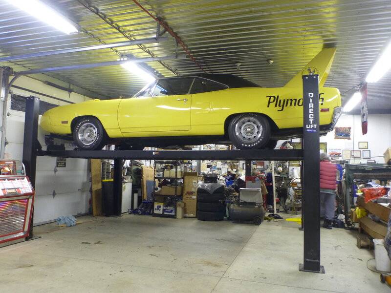

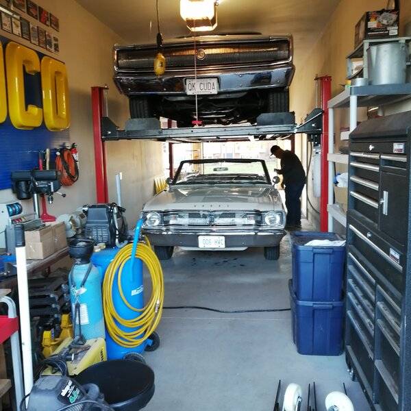

Advantage 4 post here. Mainly storage and oil changes. Rated for 9k lb but I’ll never have more than 4K on it. Nice lift, dealer here is always at the car events.
The Lift Superstore for me. Certified, with heavy steel trays and American made hydraulic pump. I find it great for working under the car.

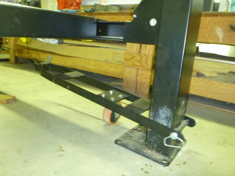

View attachment 1107565 View attachment 1107566 View attachment 1107567 View attachment 1107568 View attachment 1107569

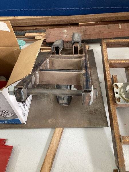

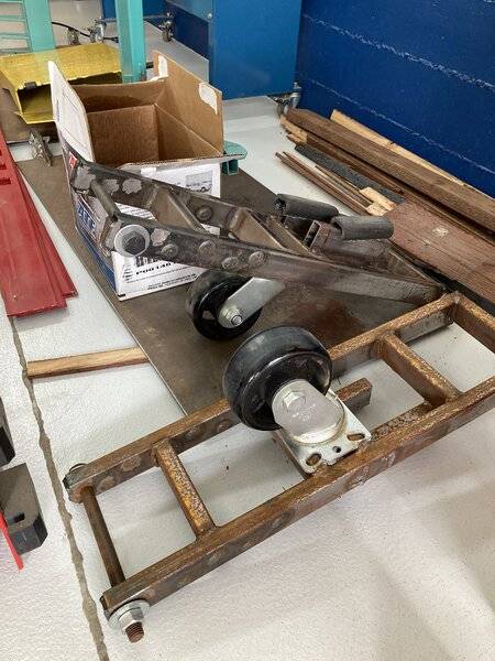

Your dollies look like the ones my BP came with. The salesman from Best Buy assured me that I could use those on the lift while moving a car around like Back Yard Buddy showed on their website with a Camaro on the lift. NOT! This is what I ended up making after I folded the supplied BP units over. The only parts I reused were the casters.
E9773E5D-BF9D-4AEE-A67C-E04F221DB2DF.jpeg 5B77393E-BEB2-467A-A618-1C00A5F5D5D1.jpeg
Yep, they're only for moving an empty lift.. one is bent from the guy I got it from turning the lift 90* after loading his car on it and hitting a floor seam.

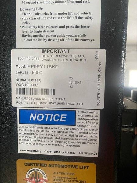

Direct Lift is Chinese....sez so on the label.
Yep.. point? They're almost all made there. Just because Rotary has a facility and headquarters in the USA doesn't mean all their stuff is made there.
Rotary is a VSG brand. VSG comprises 13 major vehicle lifting and collision repair brands: Rotary, Chief®, Forward®, Direct-Lift®, Revolution®, Hanmecson®, Ravaglioli, Elektron, Blitz, Nogra, Butler, Space and Sirio. With its American headquarters in Madison, VSG has operations worldwide, including ISO 9001-certified manufacturing centers in the U.S., Europe and Asia. This enables VSG to provide local jobs and guarantee product quality, consistency and reliability around the world. Because it is an American company, VSG's global profits flow back to the U.S."
