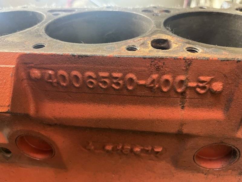

I recently had a 400 block given to me and it’s currently already .030 over but it has some pitting in one of the cylinders. From my research it seems not to be the “best year” block so I’m kind of leary on it. What’s the max oversize these can typically go? I’m going to be aiming for around 700hp with a turbo and stock stroke, street driven. Thanks

Not as thick of mains as the 72-only block, but but all the blocks are still pretty good. Your 77 has the advantage of the reinforced motor mount ears.

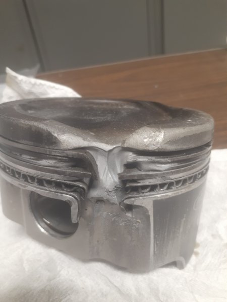

This is from a turbo car running lean, 400 block
Not sure a friend sent me that picture, when we were talking about boosted cars
