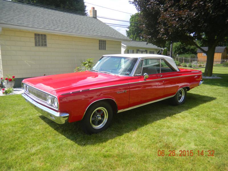

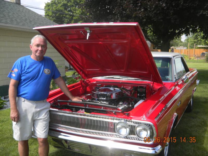

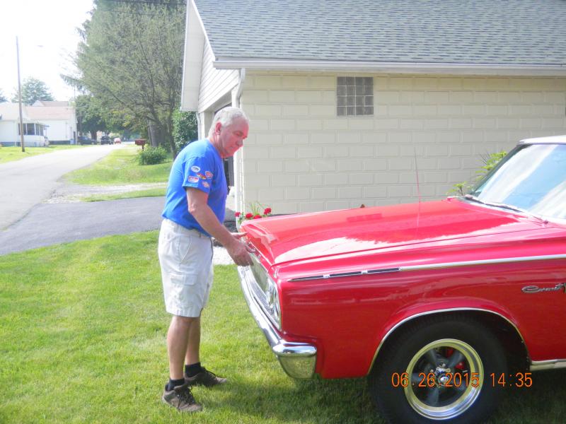

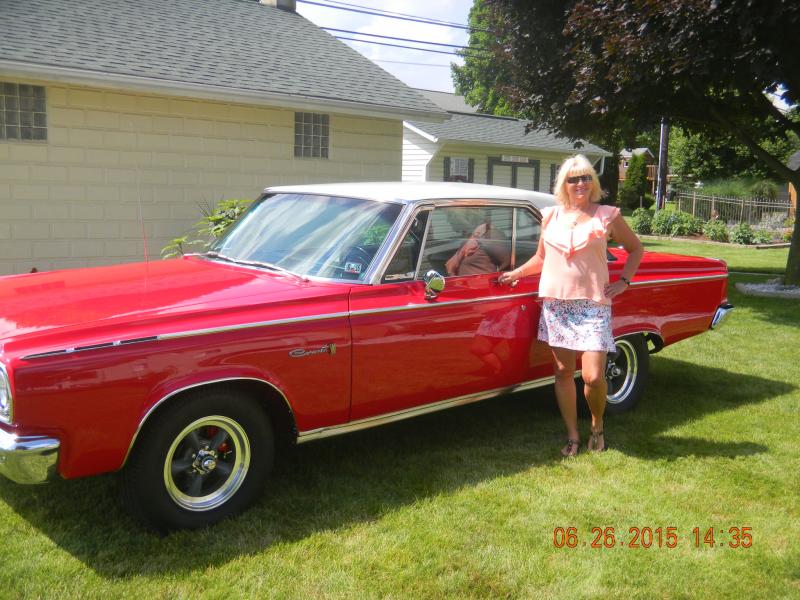

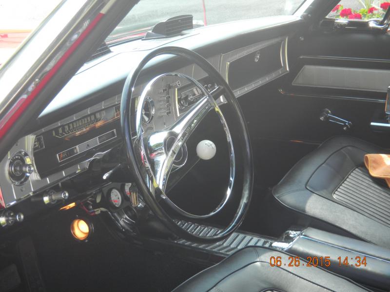

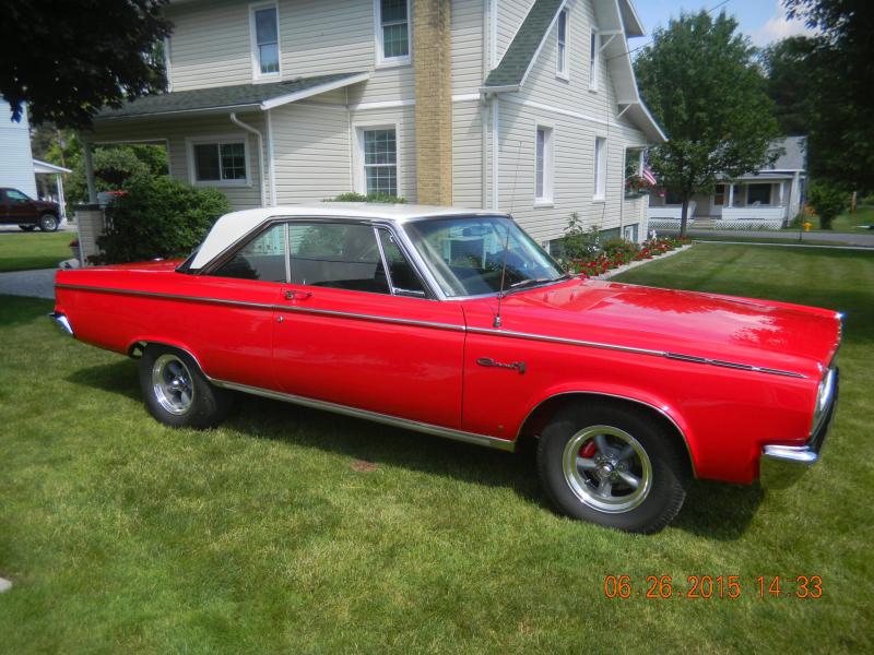

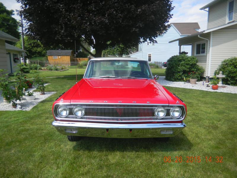

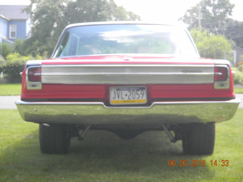

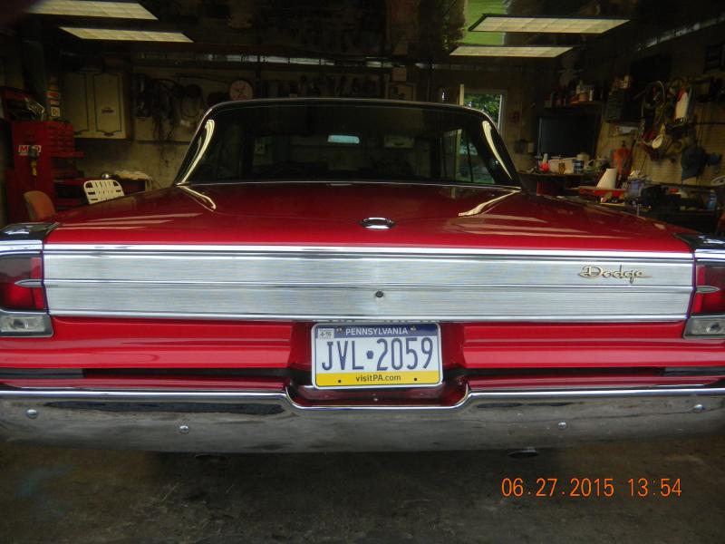

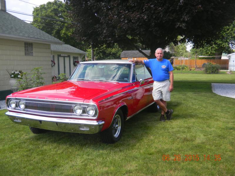

Hello Folks,The coronet is finished! I would like to thank FBBO for allowing this thread, it has been a haul to this point almost two years to date.Special thanks to Bill Overcash,Bruce Dunlap,Alex Dunlap,Mike Hostler(Hoss) Zack (5.7) Mike mccracken garage and Clair vincent (exhaust) Delmar Baker,Tony and Ryan,Randy Moyer auto glass,Don Carnell,Jeff Myers,Doug Horvath (parts) The Ram Man (Brakes), PST suspenion,Brewers, Tri city Plating,Mccellan's Auto Body,Bob Brubaker,Joe Suchy (parts and advise),Bill Coady towing,Paul Rodland (machinst),Jim Drain for finding my block,Rhoades Performance (Dyno) and of coarse my helper my wife stood by me the hole time while getting brused and scratched see pictures what a wife. Now comes Dan Baker President of alumicraft street rod grilles.When I started this project the trunk panel was dented and pitted from being pot metal,and impossible to find one having the quality I was looking for.I did find one but the price was not in my budget.Dan Baker of Alumicraft also a relative of mine said he could make one.This man is a superior self made machinist.and did have the knowledge to program this panel in his CNC machine.He had many hours devoted to this panel and was determinded to get it perfect and it is.The 1965 dodge coronet 500 trunk panel trim is programed in his CNC for us 65 coronet 500 lovers if you need one at a don't break the bank price.He also has a website so check it out Alumicraft street rod grilles in Bellwood,Pa I can't forget Jesus Christ for giving me the talent I have.My next project is a 1965 corvette I found in a barn near home.I will be starting this project next week. Thanks again for following my thread.Keep restoring.Dave L

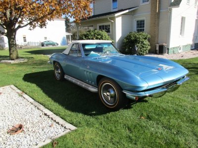

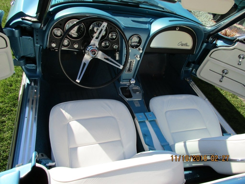

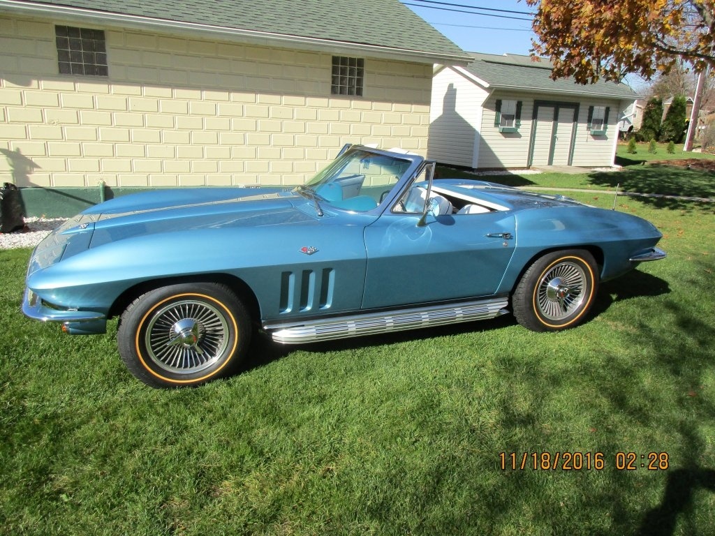

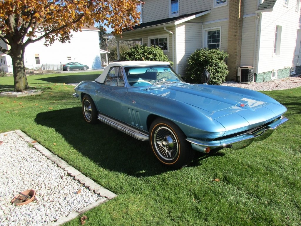

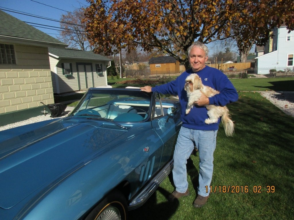

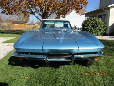

Hello All,I got the corvette done.Looking for another project
finished 138.JPG finished 140.JPG finished 146.JPG finished 148.JPG finished 154.JPG
Looking good Dave! Love the C2s. I hang out at The C3 section at CF sometimes. That place is nothing like this place though!
Nice job Dave and I wouldn't expect anything less than perfection from you .
Hey Steve, I don't have a preference anything that will keep me busy, without rust.
Looks like Dynamat or a similar heat shield product!

The insulation I used is Dynamat.I got it in one of the shows in Carlisle Good luck on your project.The 65 coronet is a blast to drive Its going to tough to get rid of that one

Hello.The 426 engine work was done on a C and C machine.It has a cloyds .005 under size timing chain.I have 3,000 trouble free miles on the dynoed 500 hp monster.The transmission was updated to a 18 spline hemi.The original trunion 4 speed is stored away
