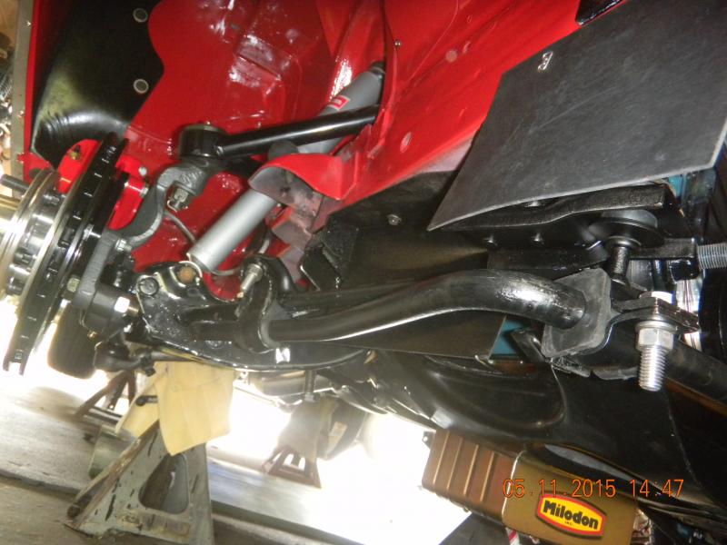

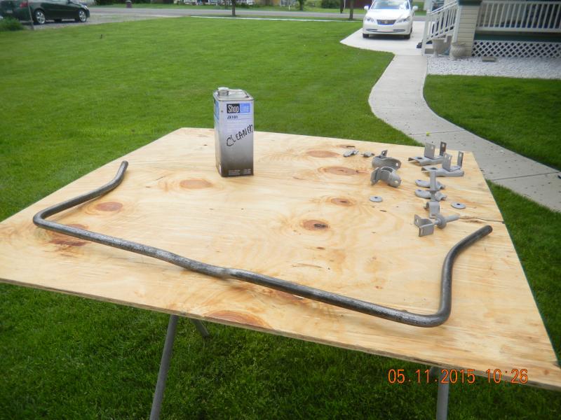

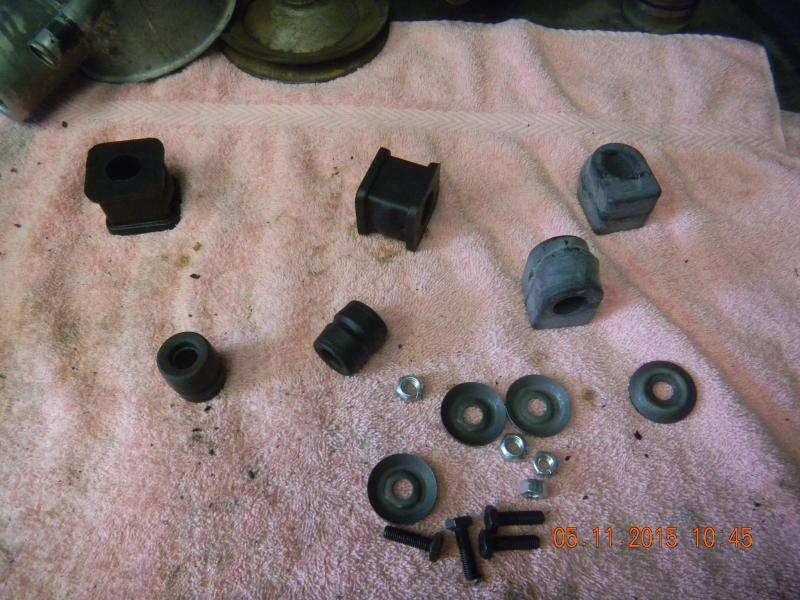

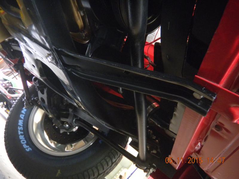

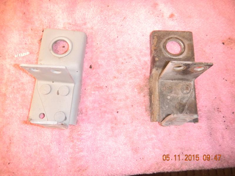

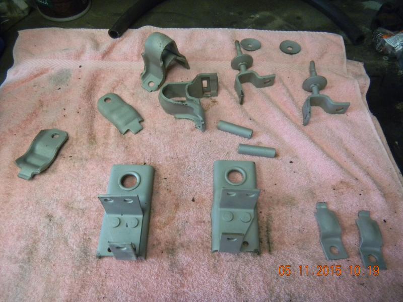

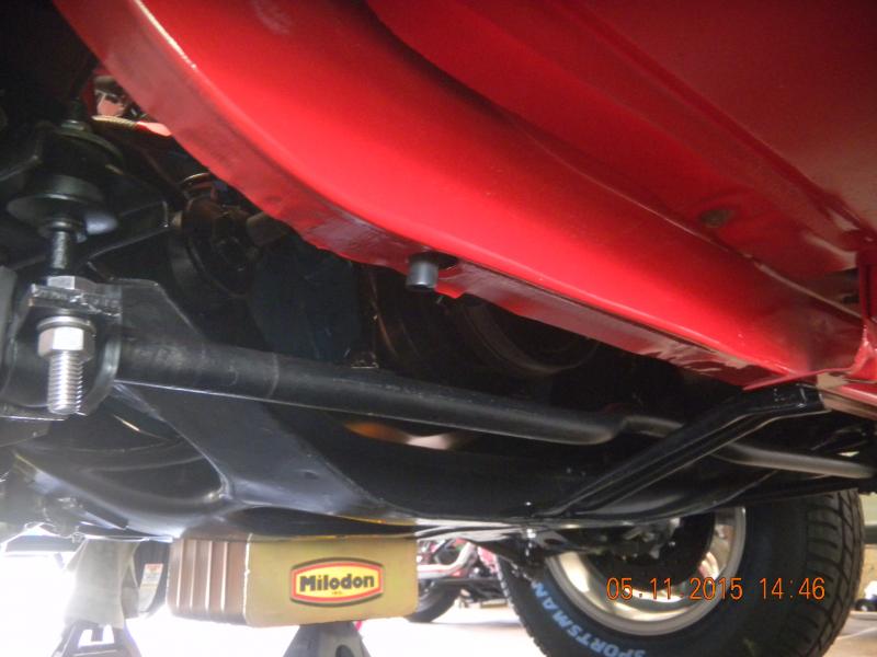

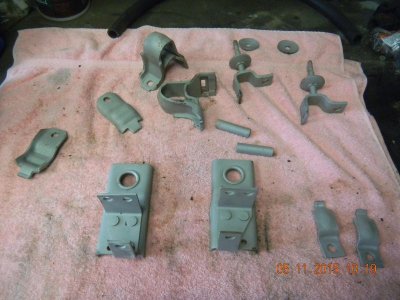

Hello Folks, Today we installed the sway bar. I was lucky enough to find a rebuild kit for my original bar The cabinet blaster sure is a time saver, My wife blasted all the small parts and I painted them,a little tough getting the new rubbers over the bar.

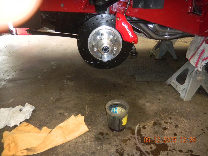

Hello Folks, Wife and I bleeding the brakes today. Fun Day

Dave I need the same rebuild kit....can you give me a lead on where you sourced yours from??
Not long now ...car looks and sounds awesome, you and your wife have done a marvellous job
The early sway bar kit I found on E-Bay. The store is Temeculavalleymopar, here is the Item number 321292744869.

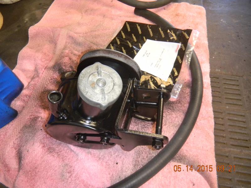

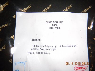

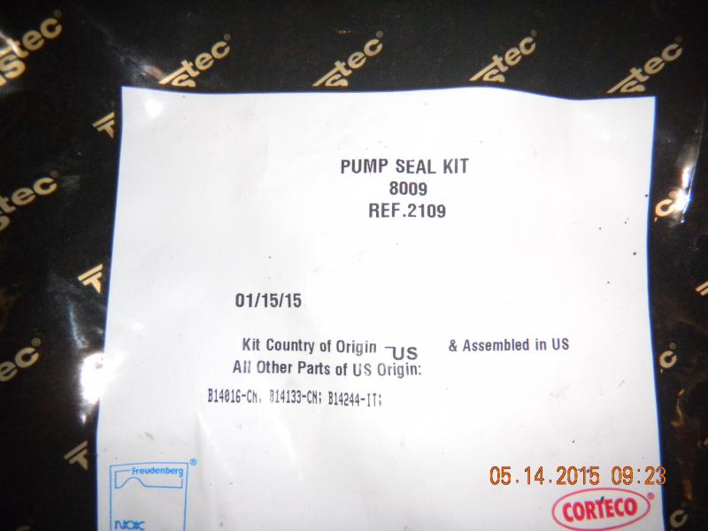

Hi Folks, I was not sure what power steering pump to use,after shoping for brackets for a saginaw pump I decided to re-seal my original TRW. I got it on today and it works perfect I also got a bunch of little things done

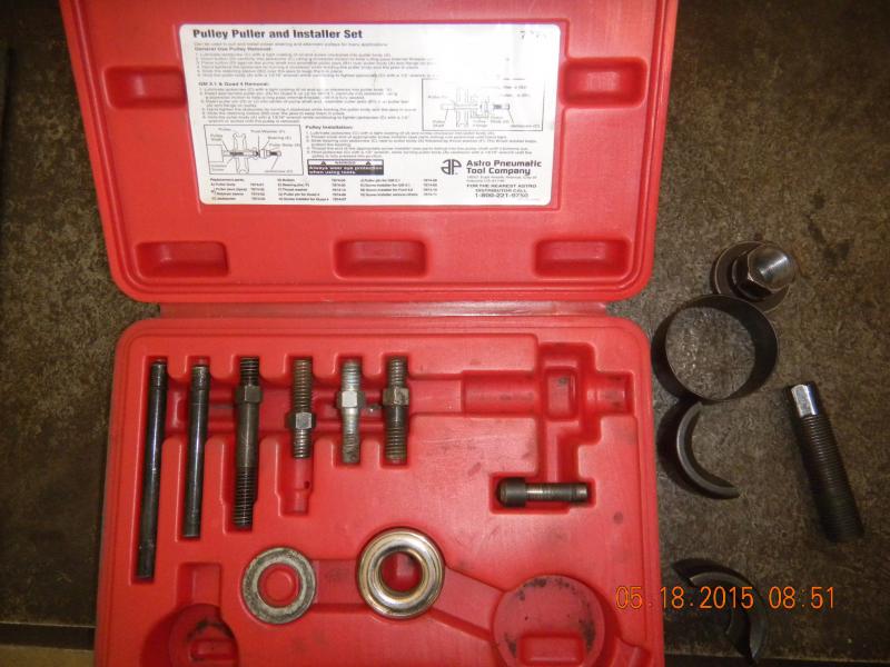

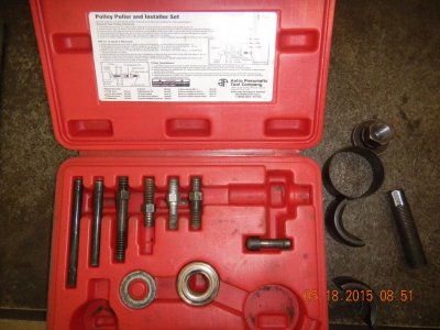

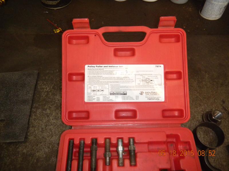

Well done!! I tried for 6 hours to get the pulley off mine to do the same but gave up. Can you please post a pic of the puller you used Dave?

This puller will make your rebuild alot easier you can also use it on alternator pulleys,its inexpensive at Harbor freight or some other discount tool store. This is the first time i used Temeculavlleymopar no problem.

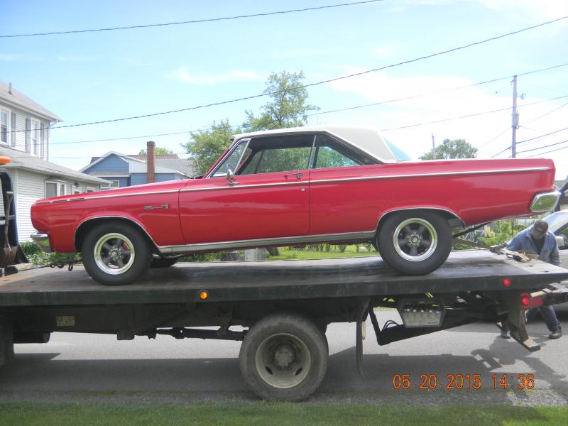

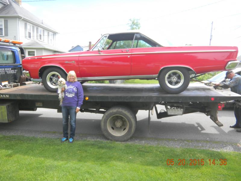

Hello Folks,To the alignment shop.My friend Bob brubaker has a local garage here in town that does alignments. Bill Coady is doing the tow, the coronet has lots of miles on that truck. It helps having lots of friends.

Dave, I think you jumped the gun getting an alignment without the full interior, full tank of fuel, 200lbs. on the drivers set. It may not be a big deal, but just throwing it out there.
Car is lookin' BITHCHIN!!!!!
