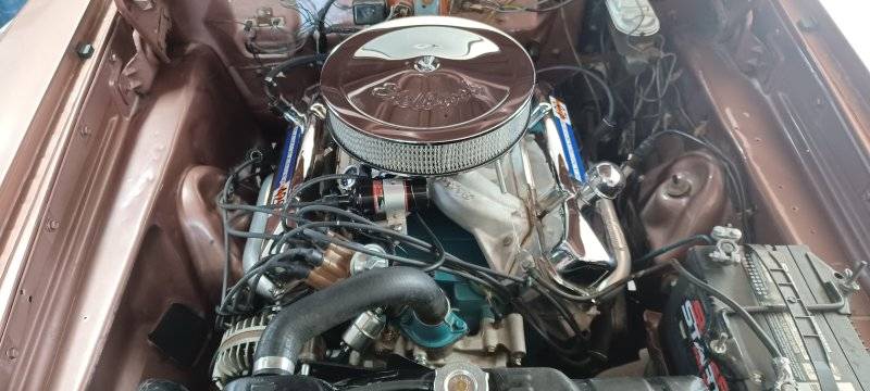

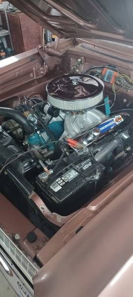

Curious about my 426 wedge horsepower in my 65 satellite,hasn't been dynoed.it's426 bored to 438 balanced line bored decked edelbrock Performer heads 10 to 1 race tech pistons comp xe 284 hydraulic. Cam 750 street hp holley with 2 inch tube dougs headers.torker 2 edelbrock intake.
Just guessing HP could be anywhere from 390 to 430 max 450. This depends on you altitude from sea level.Also density altitude on a given day.
If you got 450 HP out of it at adjusted altitude, that's pretty good. Of course it all depends on where you are in Colorado.
I believe most people when talking hypothetically horsepower like we are here, we are speculating on it’s possible corrected engine dyno hp which has the most meaning for comparative purposes.

Without doing the math I’d guess that’s close to 450 hp in a 4000 lb car in decent air (1000 ft DA)
I was at a friend's place when he ran his newly built 426 Max Wedge on his dyno. 465 h.p., 510 torque through factory exhaust manifolds. This is going into his '62 Dart 440 clone. Yeah, he has his own dyno in his shop! I figure H.P. for this poster's engine at 440-450.
