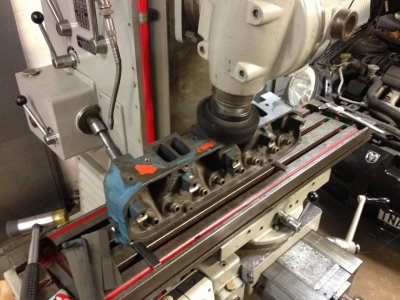

Head recipe:
452 1976 heads
stock valve sizes
pocket ported with Mopar templates
port matched with intake
milled 0,0433" (1,1mm)
backcut valves
Milling the intake surface.
