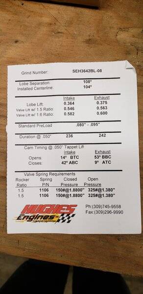

Almost 2 years ago was my last 500hp 440 build. Almost the same specs as you are planning (heads, 3.23, aluminum pistons/rods). I used Hughes cam/ lifters and Hughes 1.5 rockers/pushrods, MSD, Eddy Perf RPM intake. I love the Hughes cam, better than any other I've had. My compression is around 10.6. I engine dyno'd for break-in, tune and some pulls and the torque was mid-high 500's and hp was 500. Dyno'd with 2" headers and 750 holley v.s. The torque is what's important imo. I don't care how fast it goes (HP). I care how quick it is (torque) and the Hughes cam is golden for that. This engine is in my heavy Cordoba so almost as heavy as your charger.
If you want some free advice try calling Hughes Engines. They are a sponsor here.
My cam (they recommended):
