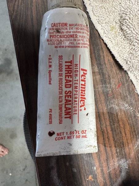

Use this on the threads. Works great on big block exhaust studs! $13.50 on Amazon. I had a leaker on my 383, sealed it with this back in 2012. Never leaked a drop since.
Just treat all the holes as being wet, to be safe.
This is the product to use, and there's other places on the motor to use it as well.
R413 is correct. Some of the older heads had some blind holes, and some wet. The later heads that you are likely to have all have the holes wet, and need sealer.
I used the same permatex as above.
