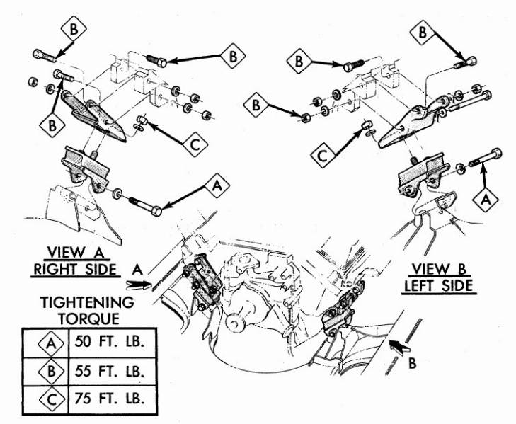

There was no instruction sheet included. This mount was designed to allow a big block to use the small black k-member. Each mount is two pieces, the rubber one and the bracket, that bolts to the block. Question is, they both are identical, except one has a tube welded into the mounting holes. So which side does it go on?

On chrysler mounts, the tube goes on the drivers side.

Many thanks for the picture.
