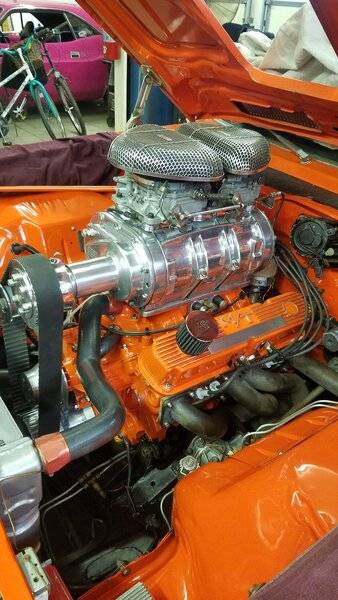

I like the idea of a blower engine, but getting everything to fit does not seem easy unless you do like the truck and re-locate the cooling system or set the engine back? Even turbos would be a tight fit and might need to cut out the inner fenders of the car?

The blower stuff doesn't take much. My street 340, 8,0-1,.550 cam, home ported 360 heads, converted 4 barrel intake, worn out 6V-71, 2 Eddy carbs. Drive it anywhere. It'll run 11.0's@3850lbs in street trim. Think of what the same would do with 100 inches more.

block or cap cracks etc.
the block webbing & saddles (45-50+ y/o blocks)
& its '2 bolt' style caps seem to be the weak link
one &/or the other
even if you were to go 'with a girdle'
the block webs & 2 bolt style caps are still weak,
even if aftermarket caps & hardware, as used
expensive lessons to learn
didn't really mean to single you out
You sure do know how to hurt a guy's feelings...:lol:
sorry :lol:
tough love, in a nonsexual way
:luvplace:
most here know what you've gone thru
I totally respect what you've done with :lowdown:
a stock stroke stock block RB/440 combo, for real
doing what guys with far larger CID/Stroked/Bored combos
have barely done
you did with a stock block & stroke
but as you know it takes its toll on lower-end parts
when you start to get at that level
one &/or the other
sorry :lol:
:luvplace:
