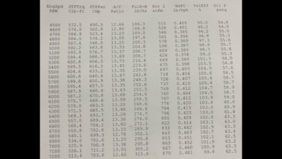

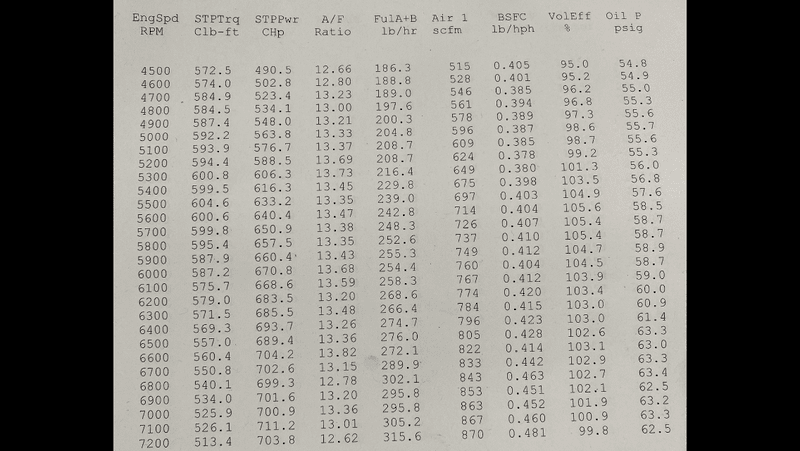

Fresh off the dyno-
446, JE domes, 13.2:1, bowl blended EZ-1’s, 440-3 intake(ootb), APD 1150 carb from owners other motor, 270/274-108 roller, 1.5 rockers, 2-2 1/8 x 4 dyno headers:
