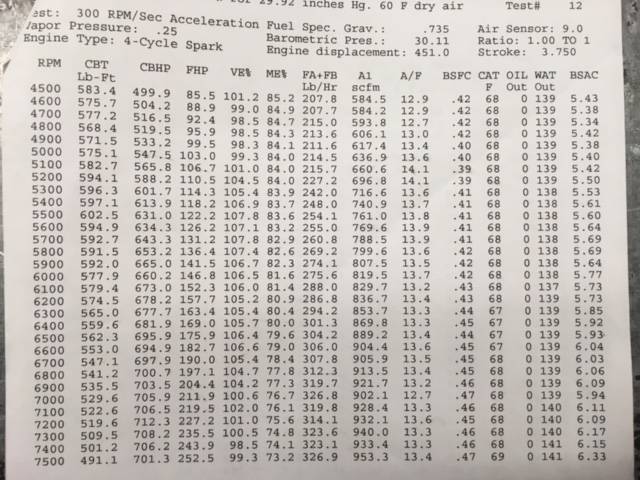

Thanks PRH! Was that dyno sheet a 440? Interested in head and cam #s.
Glad we're back to the roots of the thread
440 +.055”(451ci)
13:1, .650 roller, 275/275-108, ported SR heads(flow 340), 440-3 intake, 1050/4500 carb, 2-2 1/8 x 4 dyno headers.
It sounded killer on the dyno.

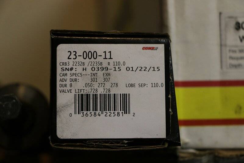

Found the box for the current cam:
I would change the exhaust to an exhaust lobe profile if I did it over again, maybe even drop the duration slightly for my heavy car.
