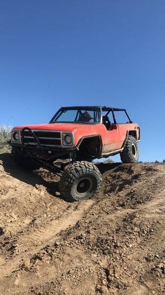

Pictures as requested
440 with msd efi, dana 60 front 14 bolt rear, 5.38s, FMVB 727, atlas transfer case, full tube chassis (ultra 4 spec) 42" TSLs. Basically a fully capable prerunner designed as a lifted old rig
