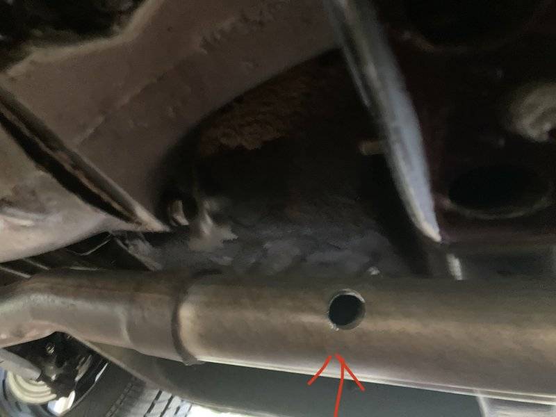

Where do you have the O2 sensor mounted? Must have at least 2 feet of pipe after the sensor otherwise you'll get lean readings.
The best place I could get to was just before the transmission crossmember. I had an o2 sensor in another vehicle for carb tuning, and it was about the same place, and that vehicle runs absolutely perfect, so I don’t think o2 position is a problem
