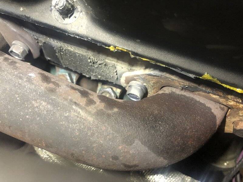

Picture of #2 exhaust flange - looks like some tannish discoloration...??
Looks like the gasket is blown out. Take a piece of rubber hose and hold it to your ear. Then other end around the header flange

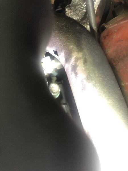

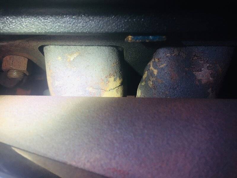

I also only found the same noise source after a close up inspection.

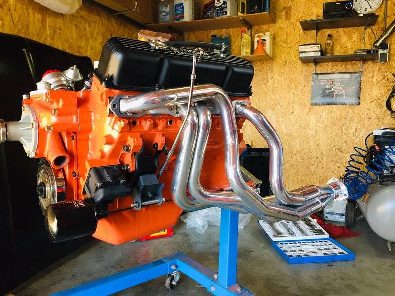

These headers i replaced with a new set from TTI (highly recommended).
I believe welding on these thin tubes will cause new cracks at the edge of the welds when expanding/contracting during temperature differences due to the material property differences that exist between the actual weld and the original material.

They are very thin - not sure what brand they are but I'm not a huge fan of them to begin with. Those TTI's look nice - will do that upgrade whenever I pull this motor out.
The brand of the old header is unknown to me, but yes the wall thickness was next to nothing.
These TTI's look good and have a bit more wall thickness then my old ones for sure, plus they are ceramic coated inside and out which hopefully protects it from corrosion for many years to come.
Just a tip, if you but the TTI's they come fully packed in bubble rap, don't throw that away!
When it is time for installation you can wrap the headers again to avoid scratches, you might know (or will find out) that installing an RB engine with headers is a PITA for space.
Specially the ceramic coated, i ended up with a few light scratches but none of them show any rust or so after 8-10 months since installation.
Not that you felt like buying new headers but at least the engine isn't hurt
