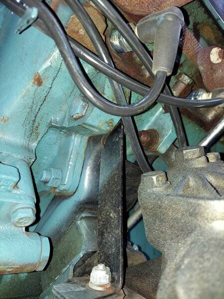

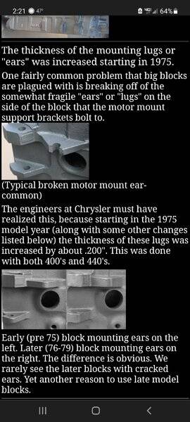

Mine is just a stock 440, but we all know the mounts don't get along with the torque.

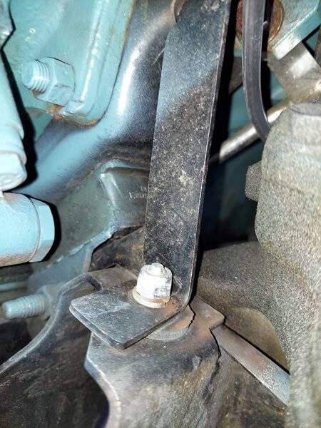

This is what I did, strap attached to inside of the mount plate on the top boss, then down to a pre existing hole in the K frame (I did enlarge hole to accept 5/16 bolt with a nylok nut) thru bolted with homemade rubber bushing top and bottom. Works like a champ, out of the way and no vibration
