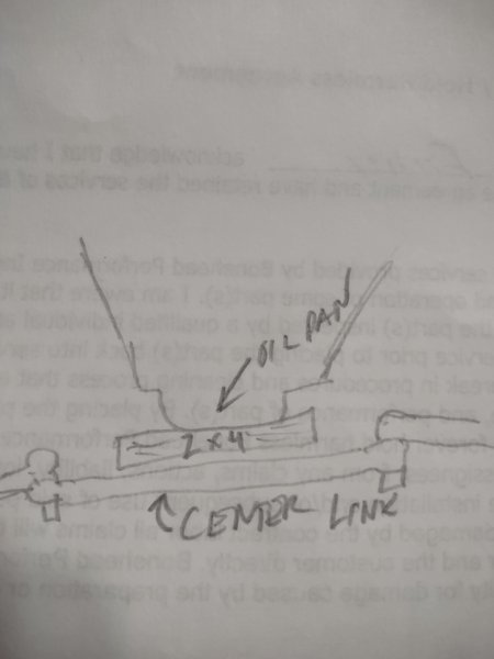

The engine will rock backwards when the bell housing is removed.
I've found that a short piece of 2"x4" set up on the steering center link is enough to keep it from moving too far.
Drop the rear of transmission, 2x4 on center link jack under trans pan
Hi Don. Can you explain or illustrate your 2x4 trick? Not quite sure what you mean.
Looking forward towards the front of the car .
I appreciate the drawing, Don. I kinda figured that’s what you meant. However there is about a 3/8” gap between my oil pan and centre link. I may have to use a thick piece of steel or aluminum or even just ratchet strap it in place somehow.
