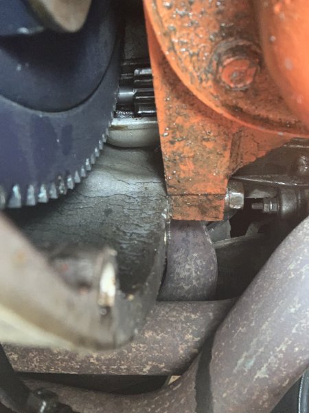

Just took it off and yep, there’s shrapnel sitting at the bottom of the bell housing. Sonuvabitch! I’m trying to squeeze my fat head in there and I think I see broken teeth on the fly wheel and the starter gear is not even close to it.

If you have broken off teeth on the converter as you stated =
Transmission must be taken partly out and a new ring on the converter installed
That means converter must be removed.
Mark the position of the flex plate to converter position as it only goes on one way.
This is a bit of a nasty little project if you have not done it before yourself and no
lift or transmission jack.
If you have flywheel teeth broken you are going to have to remove more than headers.

From what I see it's likely broken teeth on the converter or flywheel.
The Starter bendix only "kicks" out when you energize it, otherwise it would spin at engine speed and essentially self destruct.
If you bar over the engine or grab the belt and turn it a bit if your strong then try it again and it cranks you'll know.
