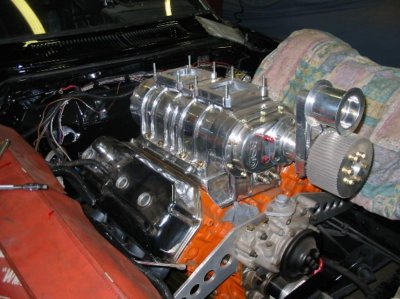

I prefer the 1 piece engine plate or in this case ELEPHANT ears,especially with a stick.:blob1:
