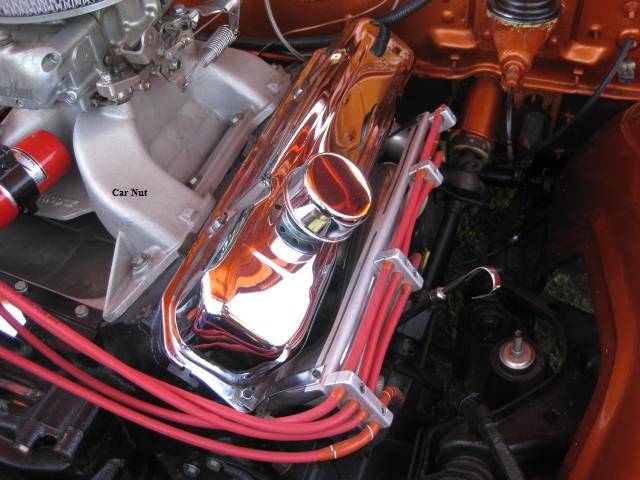

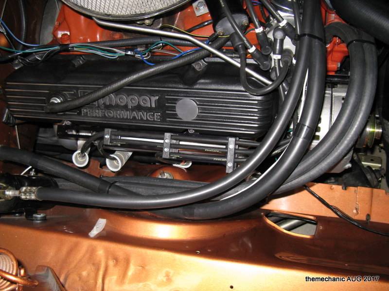

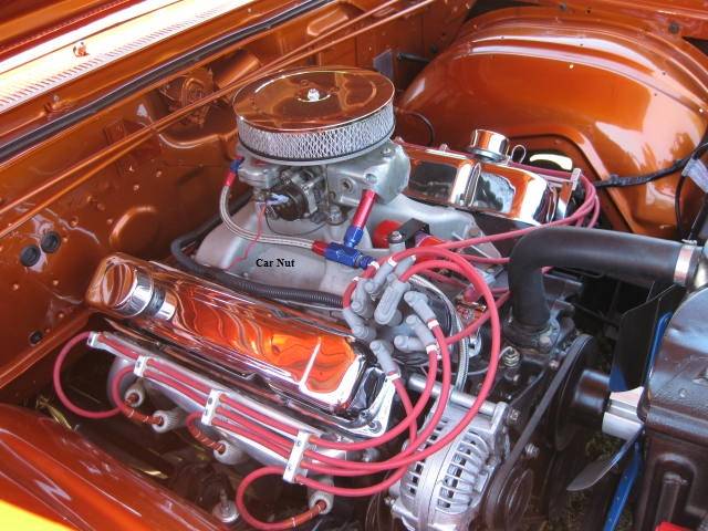

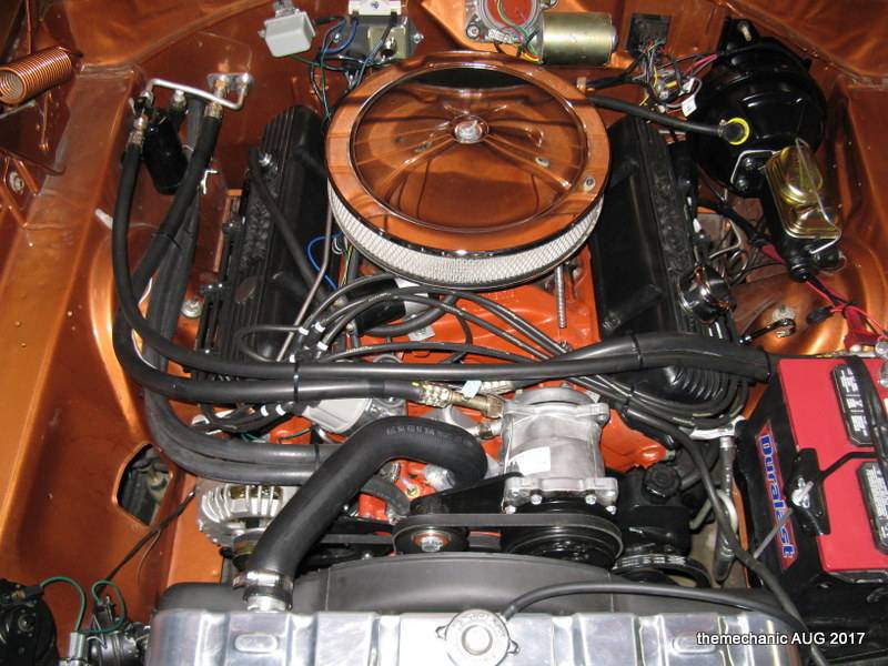

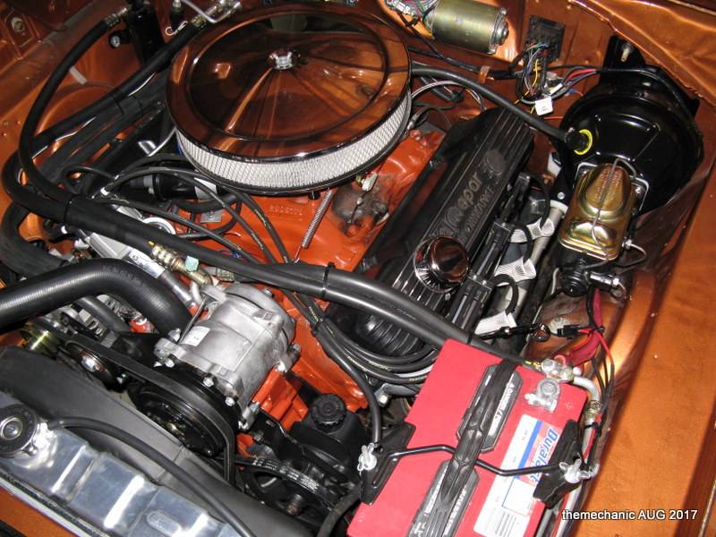

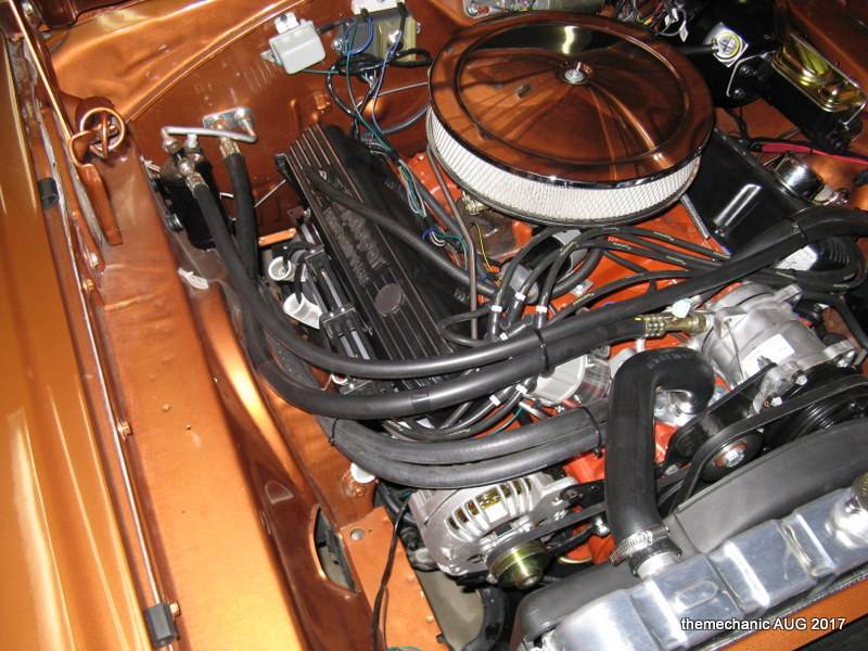

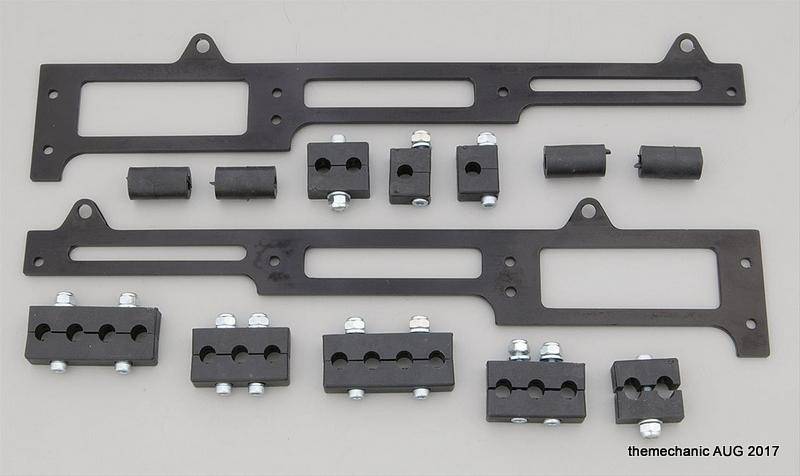

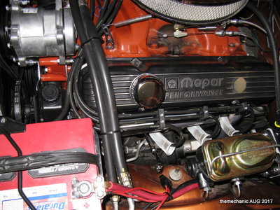

R&M Specialties Spark Plug Wire Looms
R&M Specialies Spark Plug Wire Looms.JPG R&M Specialies Spark Plug Wire Looms-001.JPG R&M Specialies Spark Plug Wire Looms-002.JPG R&M Specialies Spark Plug Wire Looms-003.JPG R&M Specialies Spark Plug Wire Looms-004.JPG R&M Specialies Spark Plug Wire Looms-005.JPG
I have that style of wire loom also. I used longer valve cover studs with spacers under the loom rail to move the loom up a bit higher.
The MSD wires (cut to length for best fit), work ok on my 440 with the 1-7/8" headers in the Coronet.
On the Charger with 2" headers, I went to the Accel 9000 ceramic ended spark plug wires.

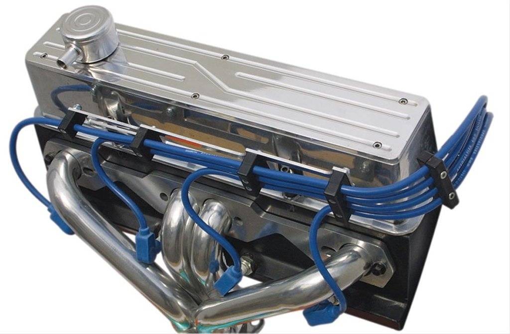

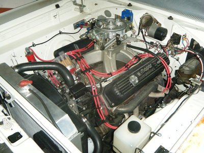

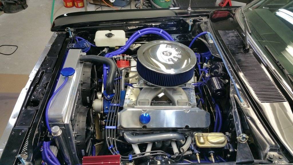

R&M Specialties Spark Plug Wire Looms here too, not mine.
I put that style on my wifes mustang, to me they are a pita! 1,2,3& 4 are impossible to get to without removing the loom. But now that everything's is done I shouldn't need to get in there until it's time to change them...
Thanks, that's the sort of thing I'm after.
How much of a pain are those at plug changing time? Do they get in the way any other time when working on the engine?
They add an extra step to Valve cover gasket changes. The plug boots hang below. The only troube I have had is getting the bots off. Firecore wires fit extremely tight. They include a bit of lube for installation to prevent sticking.
Changing plugs on a 440 with headers is never easy but you figure out which plugs you can reach from above and below the car and which tool for each.
My plug boots are 45 degree.
Reason I ask is that they look to be potentially in the way, making plug changing even worse. I also detect lots of new sharp edges for knuckles to lose skin over as well. :)
If they did such an arrangement that stacked wires vertically off the valve cover, I could see that being of benefit?

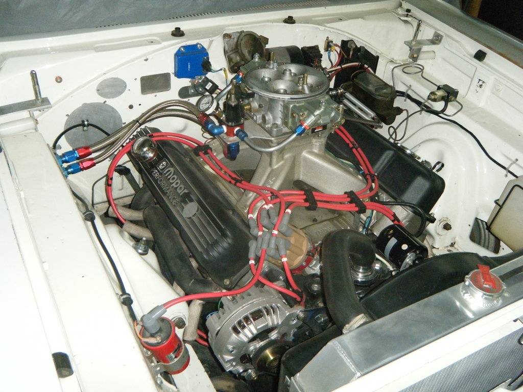

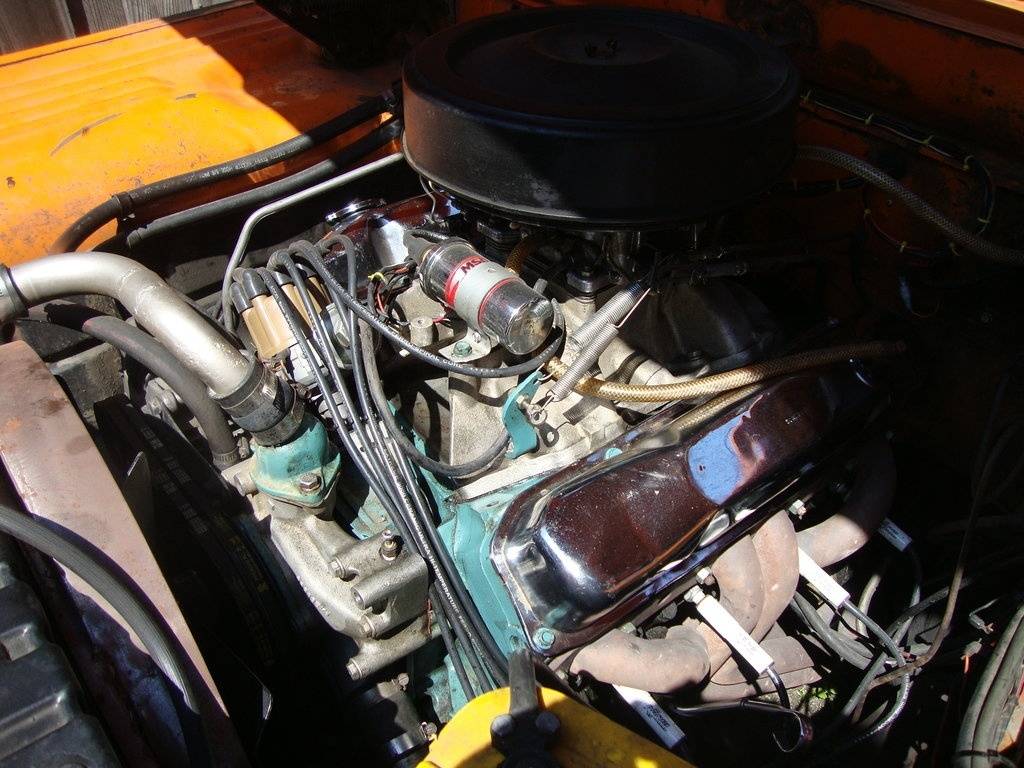

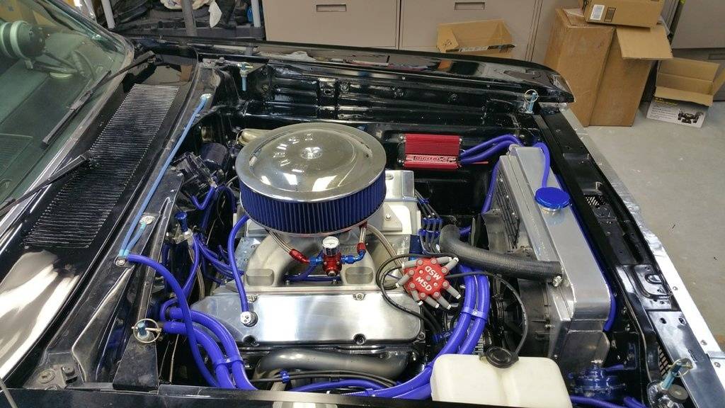

I just use the separators from MSD and route them from below. As long as your wires have the right boots you are good. Here's mine:
View attachment 499029 View attachment 499030
I'm digging those headers. I like the way they swoop up off the plugs a bit.
Yes on the boots - it appears with these #%$#$ Hedmans I'm going to need some of various type boots, including a lot of fairly straight ones.
Thanks!

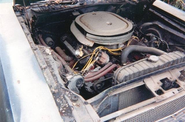

this was how i bought it and drove it , until it got parked its not pretty looking and the cats aren't getting their job done from the looks of those wires . ticket fear , lol . and two pick ups i'm doing now are the same

The headers are TTI 2" and are awesome. Changing plugs on the passenger side is a little bit of a pain but not horrible. Driver side is a dream. I can do all 8 plugs with a flex head ratchet, a plug socket, ratcheting box wrench, and a short extension. Way fewer tools than my last headers. The MSD wires have the perfect combo of boots for headers.
the blast pulse from cam over lap was cooking the booths , so ceramic ends to the rescue . heat pulse was over 888 deg from the fuel heating the primary tubes .
