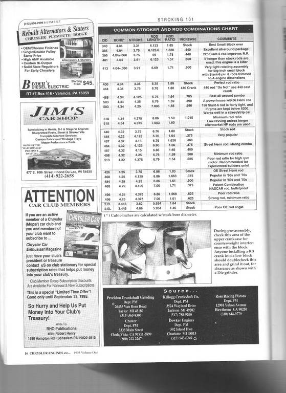

I thought you might like to read an old article on stroking... (motors you perverts)

If this was done, you would also need to have the #3 main thrust surface made larger to accomodate the new bearing. Make sure the shop can/will do this also. If you are going to run less than 600HP, there is no real need to go to the larger 2.75" mains other than ego. The cut down steel crank will suffice, and there are still a good amount of HP bearings available. Also, if you refer to page four in my post on stroking 101, there are 3 combonations using the longer 440 LY rod.
