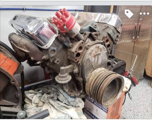

I recently scored a 72 400” engine and plan on building a 470” stroker to go in my 67 GTX w/auto trans and 3.55 gears.
Looking for a super solid, fast and fun pump gas street engine.
For those of you that have done this, what parts did you use?
Who has the best kit for crank, rods, pistons?
Which heads, intake and carb?
Which torque converter?
What worked and what didn’t?
What would you do differently?
Thank you!!
