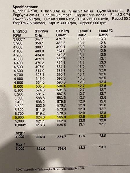

Finally completed my stoker build so I thought I’d share. Below is a link to one of the dyno pulls. Results were 624HP and 594 ft-lbs torque. Mechanical water pump and alternator were being driven. Adding my air cleaner dropped to 619HP. ready to drop in the 64 now. Super happy with how this all turned out.
400 block .030 over approx 10.8:1 compression
440 source stroker kit to 470ci
Trick flow 240 heads
Trick flow single plane intake
Harland Sharp 1.6 rockers
Custom grind Comp Cams cam (solid flat tappet)
MSD distributor
Custom built carb based on 750 QF main body

35.5 degrees timing. Distributor was straight out of the box MSD, no spring change or anything. Running this with 4.10s and a A833. As for cam specs, lift is .593/.585. 113 lobe separation, 251/250 duration at .050.

Agreed. That’s what my guys said as well. I just wanted a more true representation of what it is in the car hence why I did the run with the air cleaner. My carb tuner said I could probably get 6-7 more hp with even finer tuning but after 8 hours on the dyno with break in and testing I was good calling it there. A huge jump happened when we decided to tune for 94 octane pump gas instead of 91. That added 20hp. Couldn’t believe it.

most of my parts were very straight forward. Heads weren’t touched. Very mild port matching on the intake and valley tray. The person who did all the specs for the cam and machining did win engine masters a couple times so that helps haha. My carb guy is also a bit of a wizard. I couldn’t spec a cam if my life depended on it!

Nice. Dist advance should have been all in at the 3800 RPM starting the pull.
