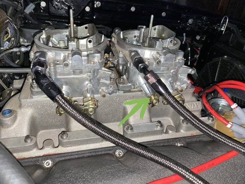

i a Little confused , because I see the fuel leaking not on the top of the carburetor , it’s leaking exactly here in this place , and the fuel dropping out there I see when I try to start the engine !
Float stuck in leaking carburetor. Tap on top until it releases.
Ohh really ? Never get this issue before on any mopar I had . Just tap on top with a Plastik Hammer / big screw driver something like this ? Why it cames the fuel out there ?

Its common for Carter and Eldebrock carburetors to have a float hang up or stick, especially from extended sitting. It may even be time to clean and put a kit in them. In single 4 bbl. applications it also is very common to run only run on one bank of the engine when this happens.
When the float or needle-and-seat stick open, the fuel doesn't shut off when it should and it over runs the fuel chamber. This causes the engine to flood with gas on the primary side, and fuel forms a lake on top of the secondary throttle blades. . This then runs out the throttle shaft, where your arrow is pointing.

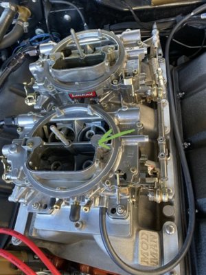

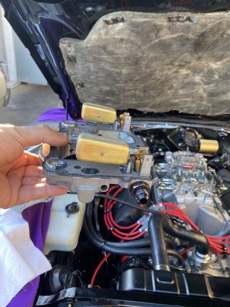

Hey guys , the front carb still over floating when I start the engine . Big amount of fuel come out on the driver site we’re the metering rod is located . Any ideas what’s stuck ? Or wrong ? Because I remove the top plate of the carburator and I not found any issue , everything also looks clean. The only thing i regonize was the accelerator pump was a little “ stuck “ and makes also some noise squeak , and I can it to a other one . But still over floating my carb

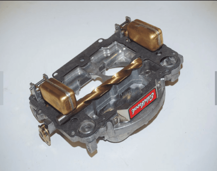

Also the adjustment from the float balls are 7/16” correct , and if I turn the top plate on the head like the picture and blow in the fuel Inline they close can not blow any air inside , means the needle so are also good and closing. Fine I not understand what’s happen , any suggestion ?

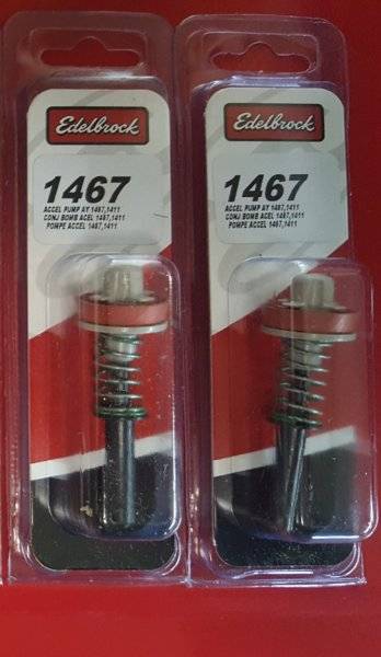

I went with the vitron accelerator pumps, #1467 on my 1407s when they started acting up. Haven't had any trouble since. Nothing to do with flooding though.
Yes 7/16" on the float level
what is the small vacuum line on the front carb going to?
you did pay attention to the weight of the floats, that neither are flooded with fuel!
No , float balls are seal and light , no fuel inside . It’s crazy , I not know what I can checking more now, but if I put everything together again and start cranking the engine the fuel runs out from the carb
