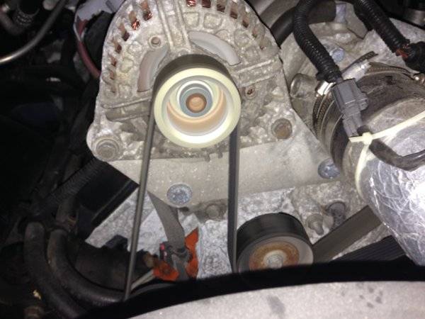

I took the alternator to a local rebuilder and he removed the rectifier and replaced it with one that the leads bolt and plug on the back. That looks like I will gain about 1-1/2" so I am on my way. Looking at a Sanden Compressor to see if I can make brackets that will work.

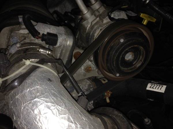

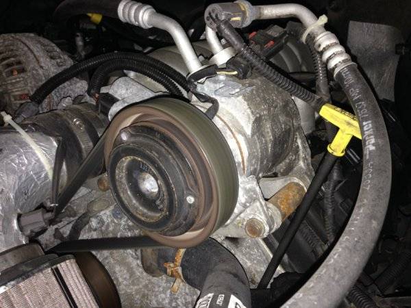

I can see the differences now after looking at your picture more closely. These are an '03 Ram which must be the brackets you were speaking about as I am hopeful I can modify these slightly to gain the 1" of hood clearance that I need.

The a/c lines (manifold) at the compressor is an easy change if that is your problem.
Sanden 508 compressor is universal, you’ll need to make brackets.
