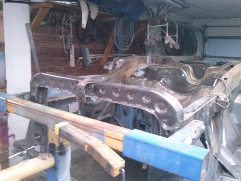

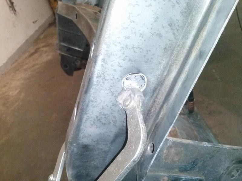

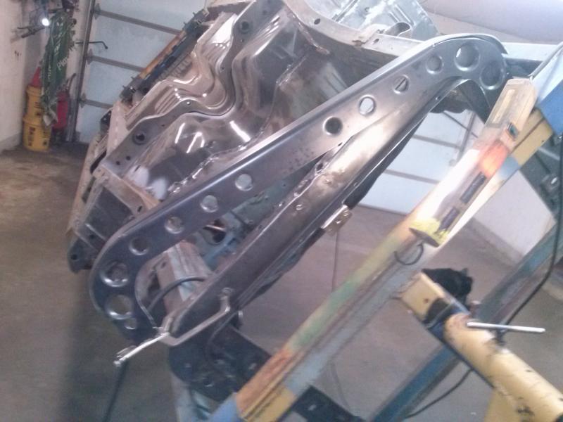

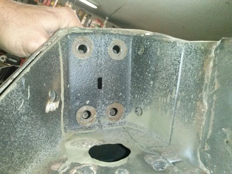

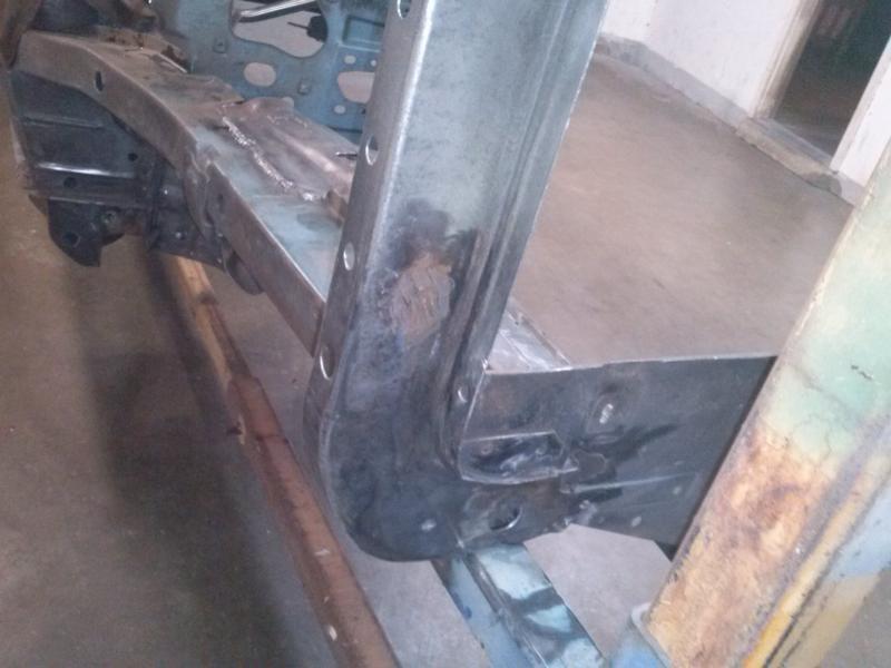

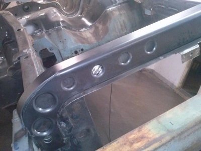

Well I got bored and figured I put the radiator support stiffener on. I was able to trim it just a tad to make it fit while in the rotis. But I didn't like the way these 2 small holes in the support were not lining up with the big holes in the stiffener, so I made some plugs to fit close in them and welded them up. They are probably there for a reason, like the trans lines or something, if so I'll drill them out to look better with the stiffener holes. In the 4th pic you can see where I drilled holes in the bottom lip of the support to weld to the stiffener and I'll also weld the big holes in the front of the stiffener to the face of support. I had to do some custom trimming on the stiffener to get it to fit right, like cut the welded ends till I get it clamped on and welding started.

I don,t think on chargers that this stiffener can be seen to easily and because I will be installing a hi hp motor, I welded it everywhere it could be welded to give it max strength.

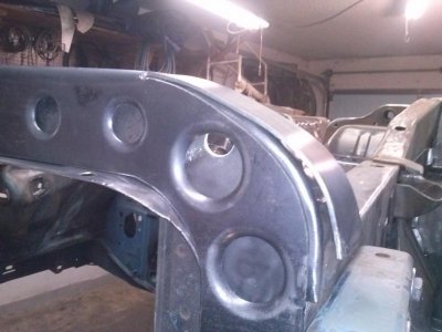

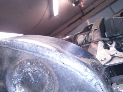

Looks very SOLID there Daytona Kid . . . I got mine installed too, and just in case it is visible, I went a little different route with the welding.
Here's what mine looks like . . . ( full details can be found on my thread - click on the my build link at the bottom )
Turned out very solid ( but did it differently then they documented )
I think I could stand on it and it wouldn't move - I'm very happy with the results ! !
( if my welds looked as good as yours, I would have a whole lot less grinding to do ! ! ! )
That does look good, and I believe it will show on yours, but not as much on mine due to my frnt valance which goes back a ways. My welds on mine are strong but not all were pretty. It was hard for me to get comfy on some of the welds., gotta do some grinding myself.

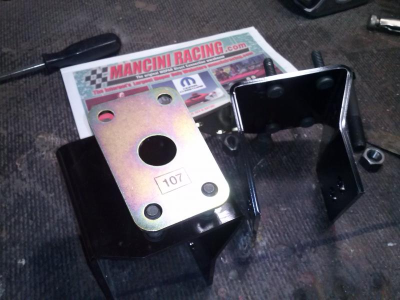

I am at the end of my rope with parts that don't fit. Got these offset spring brackets from Mancini and the studs don't line up. 1st thought it may be the fault of my car being off somehow but then checked and they don't even fit the reinforcing plates they came with. As usual I'll make them work. Thanks a lot Mancini!

Got the hanger problem worked out. Test fit of caltracs, mono leaf, offset hangers, ect. was perfect!
