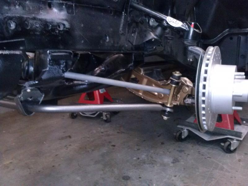

I knew this would be hard but I'm starting to believe it is impossible. I'm trying to put the new sway bar bushings in their brackets and it is not working. They are starting to break before they even start to go in. I think the factory put them in with the brackets apart then welded them together. Anybody know the trick?
Never mind, I cut the brackets, opened them up, put the bushings in and welded them up carefully, quickly and with a wet rag handy.

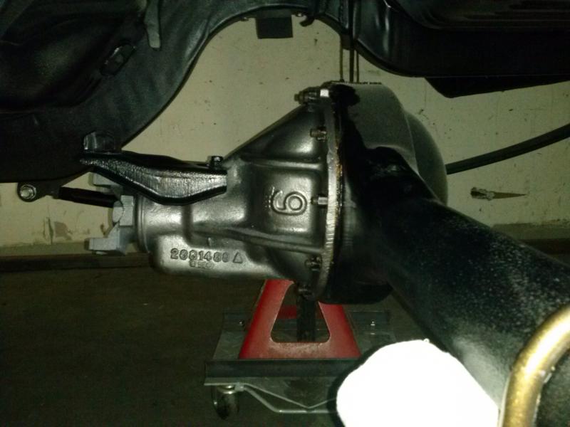

Sway-bar installed.

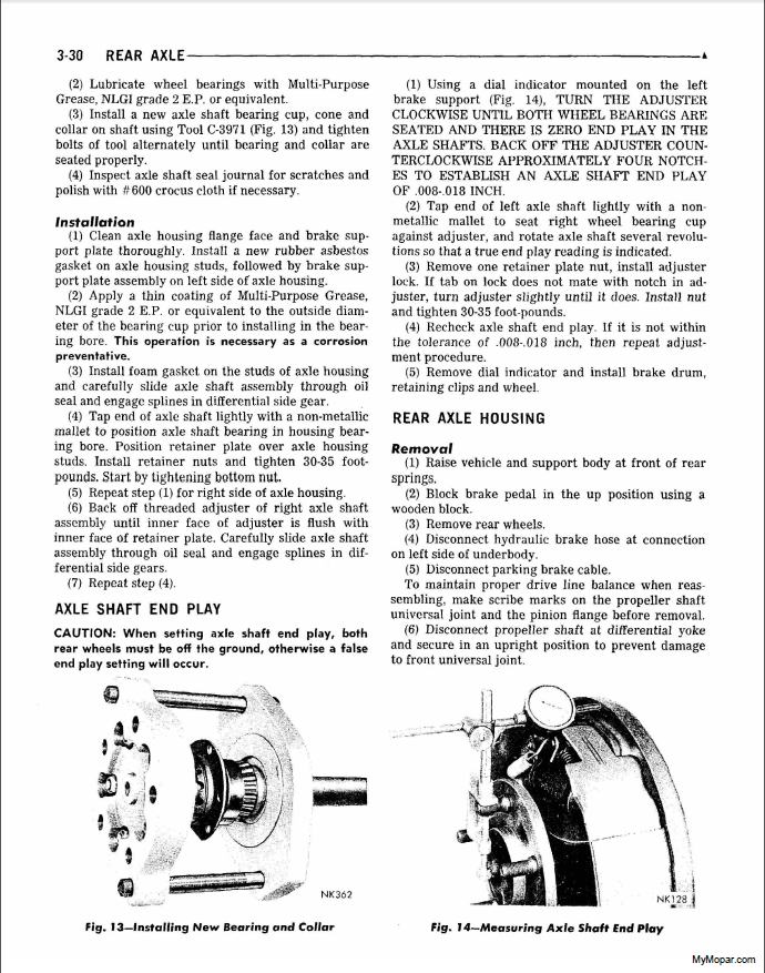

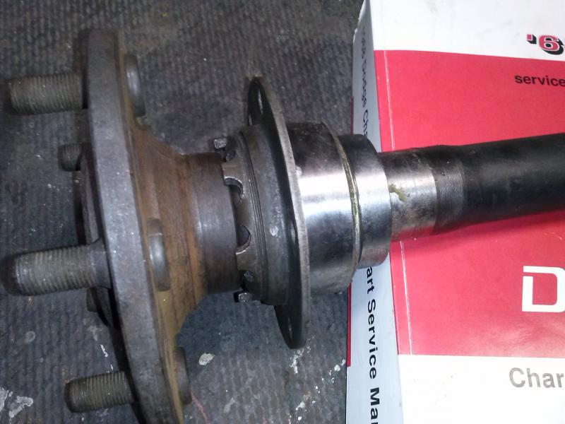

Got the chunk installed, and I have an axle question. I understand how to adjust the end play but how do you lock the adjuster ring (2nd pic) to keep it from moving after adjusting? .

That's what I needed to see. I get it now. Hope I can find that lock tab in my molasses bucket. I sure don't remember removing it., but that's what I get for throwing all the hardware off the car into 1 bucket. lol..

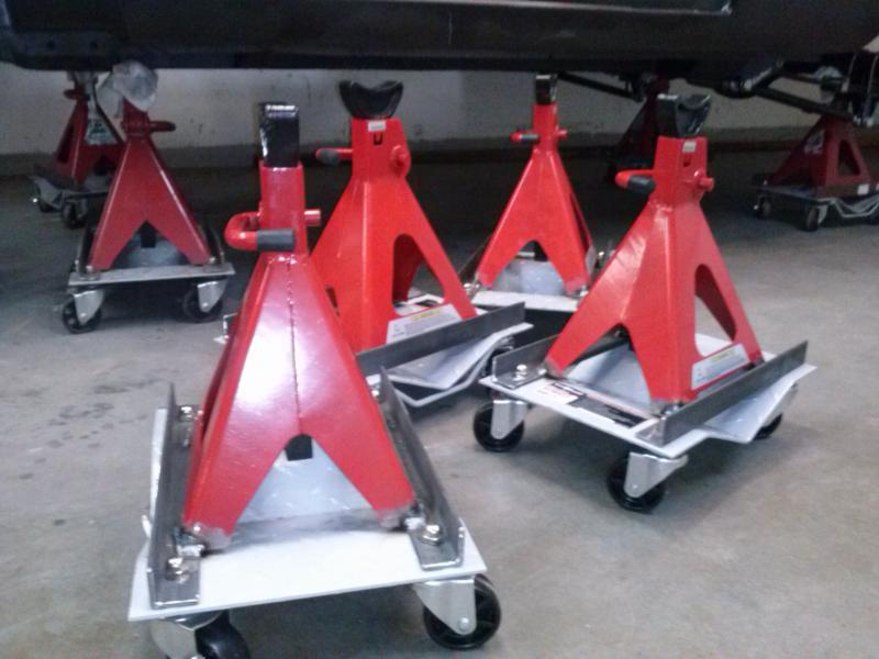

One of my buds want some jack-stand/dollies like mine so I made him a set. The stands on these are welded to the angle iron (at his request), but can be unbolted so he can also use just the stands or just the dollies. 3 different ways to use them. I may start selling these, $400 for a set of 4.

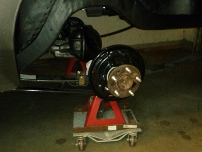

Axles and brake back plates installed. Will set end play on axles and paint them tomorrow.

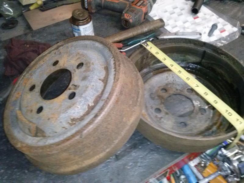

I should have notice when I removed it but one of my rear drums is shot. I've been looking for some and having trouble. I thought/hoped they were 11" but now I think they are 10" since that's what they measure I.D... I haven't seen any that look like these. The shoes are 2.5" wide. Are these 10" drums? Can you guys tell me what I have here and where I can get at least one?
This link says 10"x 2.5", is it what I need? Says it fits 68 Charger r/t. My car is not an r/t.. I assumed r/t came with 11".. I'm confused> http://shop.advanceautoparts.com/p/wagner-brake-drum-bd60140/20801022-P?searchTerm=brake+drum+-+rear

I should have notice when I removed it but one of my rear drums is shot. I've been looking for some and having trouble. They appear to be 11" but I haven't seen any that look like these. The shoes are 2.5" wide. Are these 10.5" drums? Can you guys tell me what I have here and where I can get at least one?
Measure the drum from the inside area where the brake shoes rub against it when they stop the car. I can't really tell from the photo but you might have a 10 inch brake drum. Then take the measuring tape and measure how wide the area is that the brake shoes rub against. Most (but not all) 10 inch drums have a 2.5 inch wide brake shoe. You can also measure how wide the brake shoes are if you still have them. The 10" brake shoes can vary in dimension from 2 inches wide all the way to 2.75 inches.
If your car has a 2.5 inch drum you can probably go to your local parts house and buy a set. Hope this helps.
Basically on the drum you are checking diameter (10 or 11inch) and depth (2 to 2.75)
If you can get the brake shoes and a new hardware kit while you're at it. Take in your old shoes to save a core charge.
