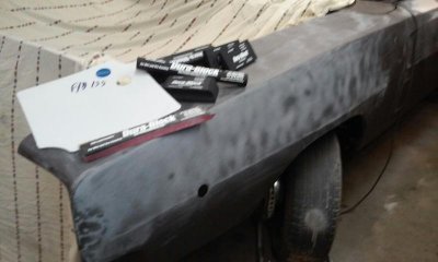

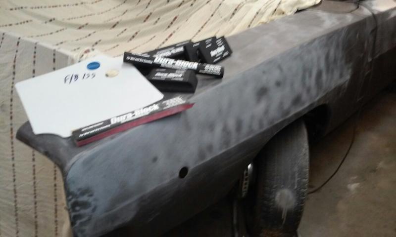

I got some of these Dura-Blocks for the filler smoothing, and going to get one of the longer foam flexible ones also., and got a teflon mixing board and a roll of sticky back 180 grit sandpaper. Did a little sanding on the fender and you can see how the Clausen primer shows the lows and highs. Those are probably due to me getting to close while blasting, but like I said I will go over the whole car with a skim coat of filler.

At least your fenders are in better condition than mine were. They will look good when you are done.

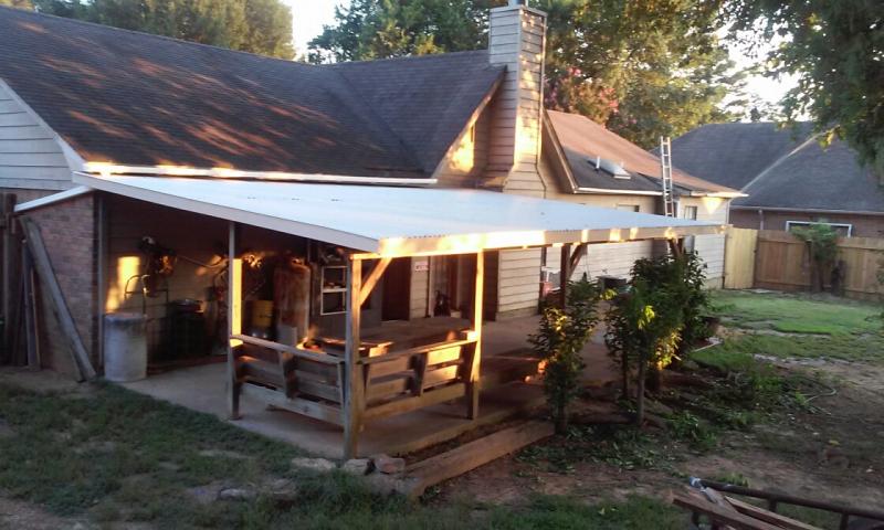

Here is one thing that I've been busy on, I had to rebuild my patio roof. The old one lasted 25 years. I made this one a little bigger (26'x16')and will easily cover a car, if ever needed. I reused the corner benches but all the overhead is new. The patio has been a nice place for me to work on parts for the car.

Sweet Daytona Kid ! ! Very nice work you did on the roof - - - I'm sure you're going to enjoy it for years to come ! !
