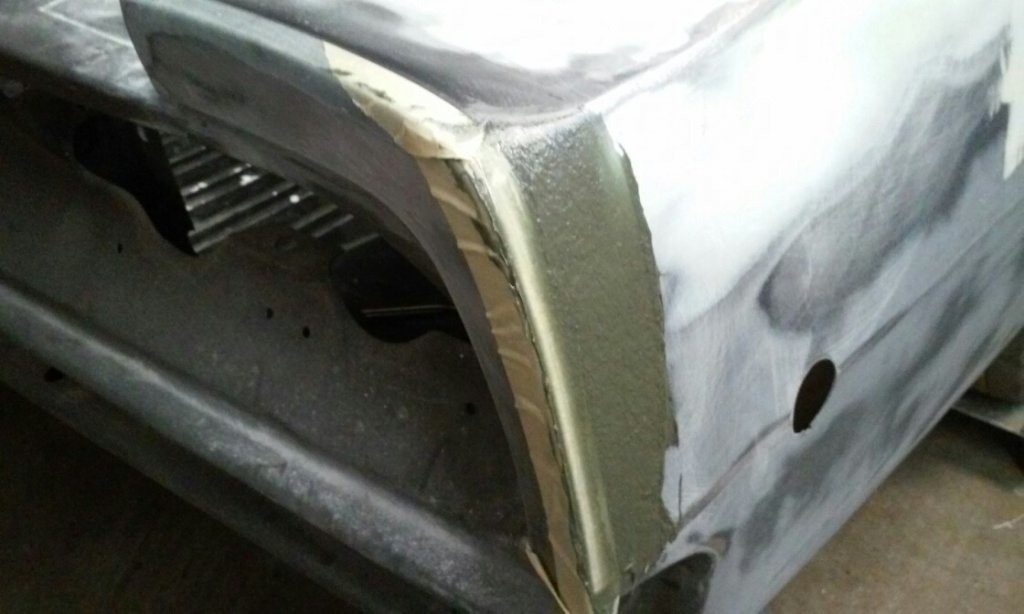

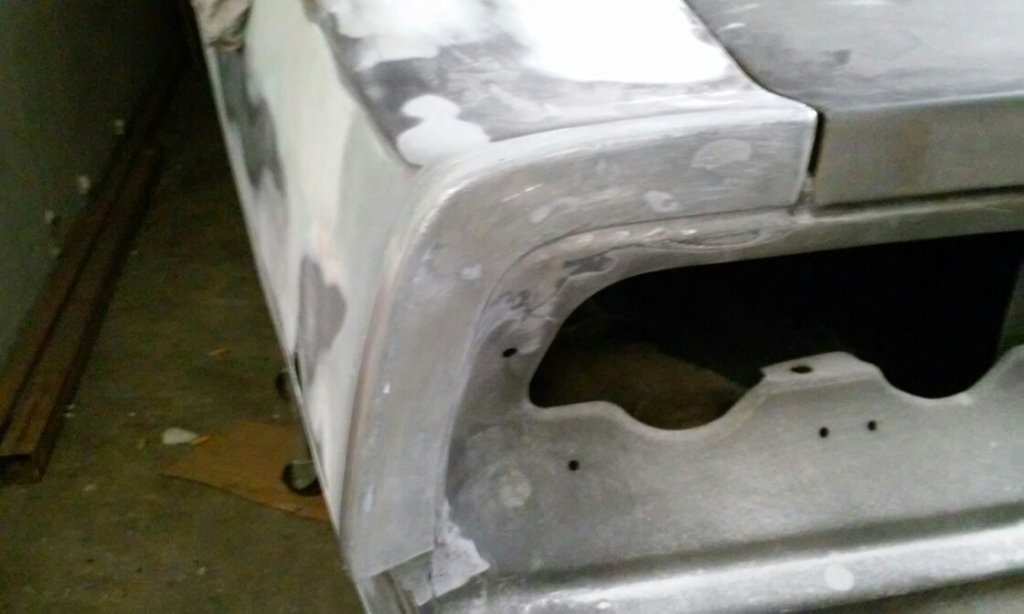

Fixing my problem with the quarter extensions so the painter won't have to mess with them. He should be ready for it in a couple of weeks, fingers crossed.View attachment 363347

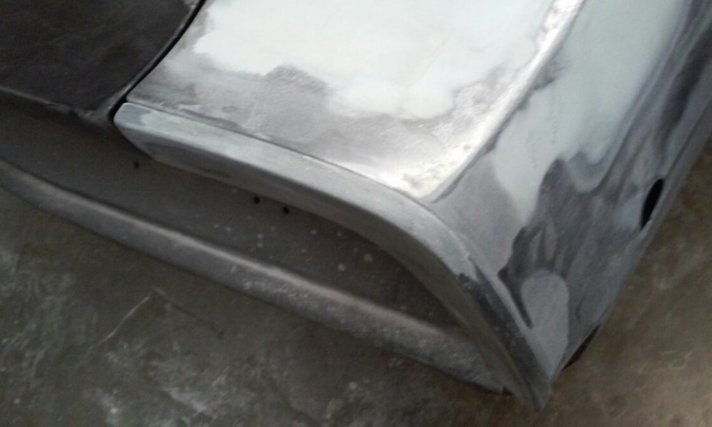

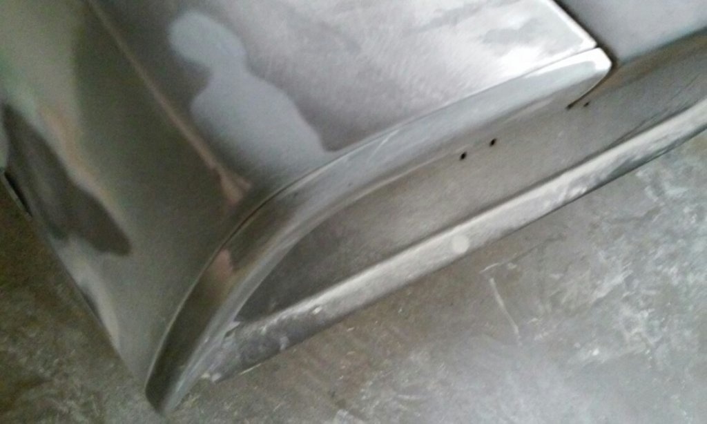

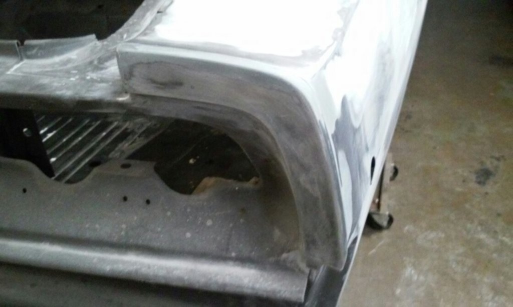

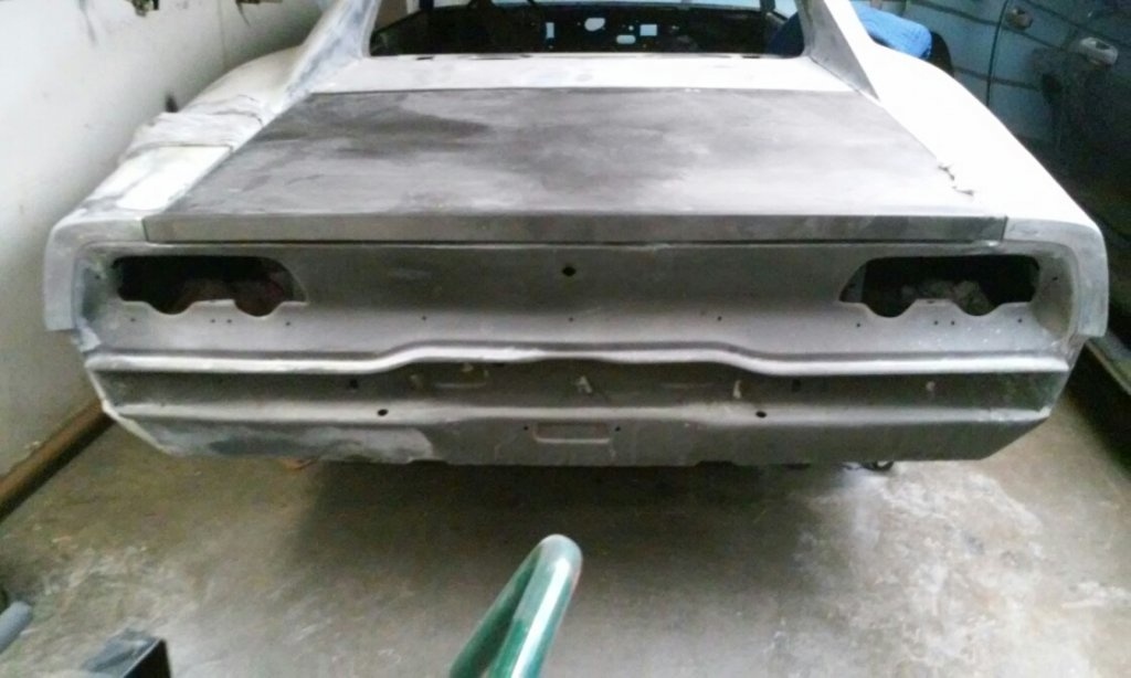

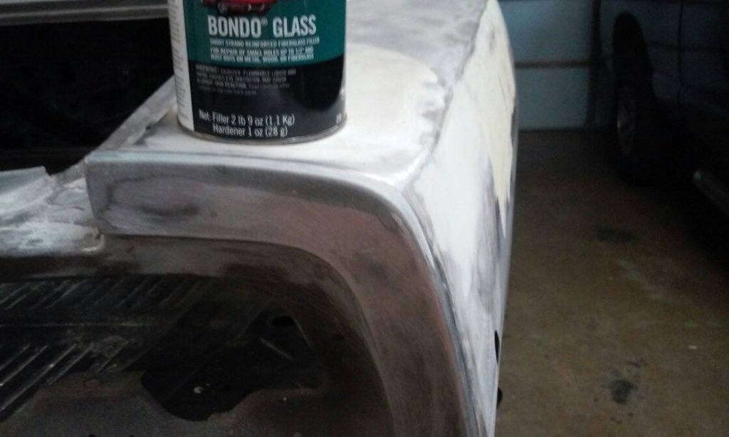

Got both of the extensions fixed. I'm happy with how they came out. I test fit the trunk lid to them also. The gaps look better than factory. I looked at several chargers the other day at the car show and most of their extensions didn't fit as close/nice as mine now. I'm going to leave them off during paint and put them on after.
I put some filler on the faces of the extensions. There were dimples/depressions where the attaching studs were pulled a little to tight, and some other small dings. I'm trying to do a few small things to help the painter not have as much to do. Should be going to him in about a week, fingers crossed..

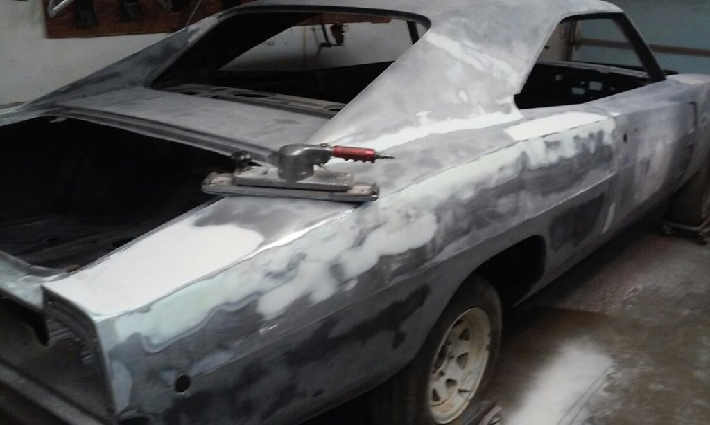

Yep, I have been doing some small body work stuff, so the painter will have less to charge me for.. He should be calling for me to bring it to him any day now.. I'm getting better and more confident with the body work/ filling and blocking., and using this line sander my uncle left me.
Since you've started the body work why don't you do it all and then let the painter do a fine tune once over? Just curious.
