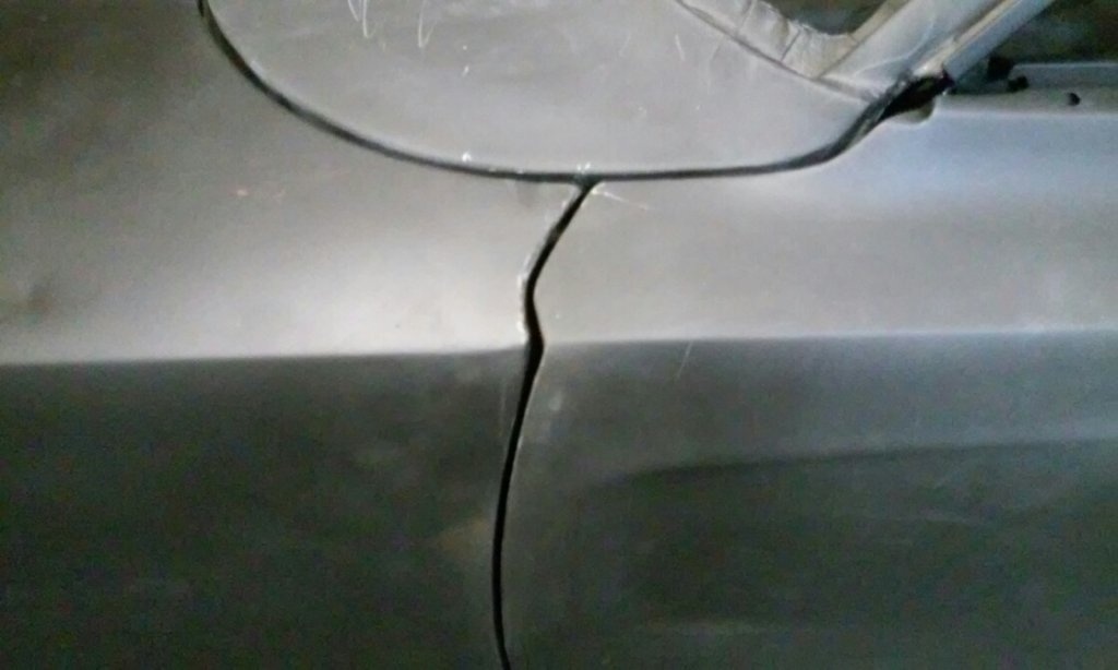

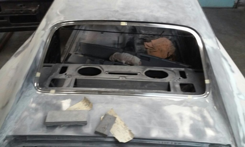

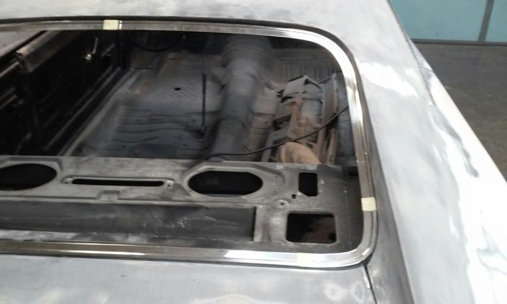

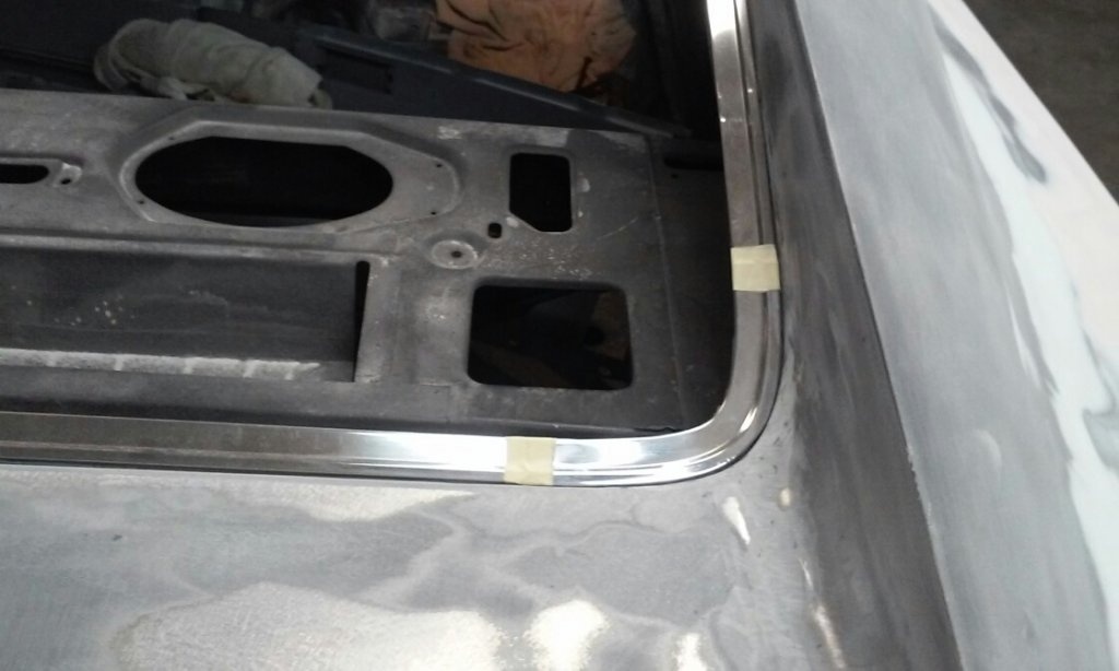

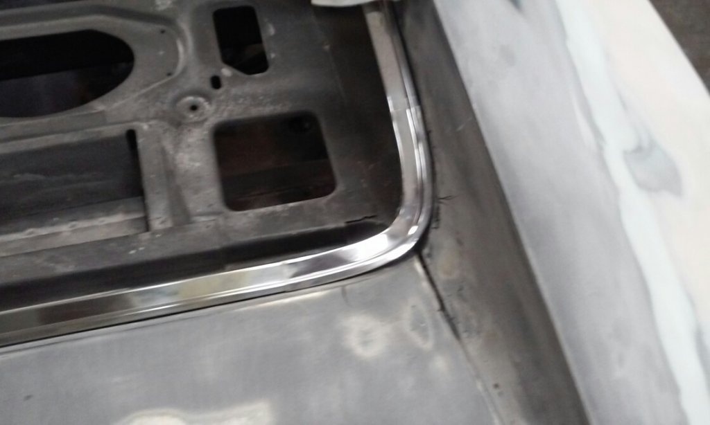

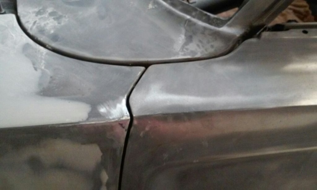

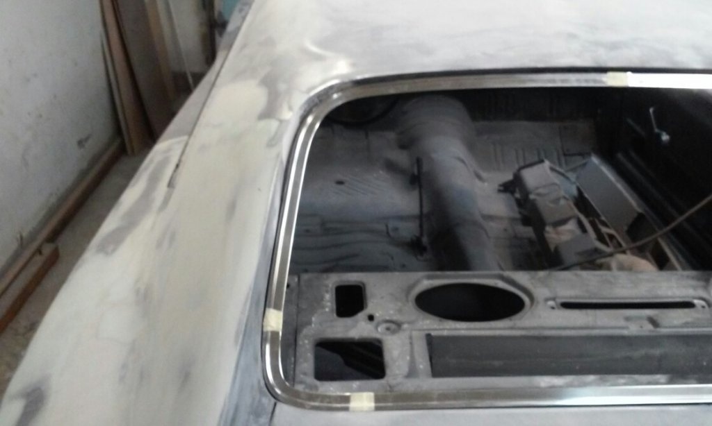

Funny you should ask,. I guess this is what can be filed under "everything happens for a reason". The painter is still stalling me, but I have found more things that need fixing before he gets it. Like the rear window area where I replaced the channel. I don't know why I had not checked this before now. I taped the trim together exactly where it was prior to my removing and set it in. The fit was pretty bad as can be seen. So I am about to mix up some of the bondo-glass and fix it., hopefully.. Also going to fill the seams on the dutchman to sail while I'm at it since one is a little too gappy..
What did you fill the Dutchman panel with? I'd be leary filling that without welding it solid and sealing the bottom? Flex in that area will crack fillers and moisture getting to it from underneath can cause the filler to bubble. Just giving you a heads up bud. Looking really good!
Thnx.. Yea, I have heard and seen how seam filling will crack. I used the bondo-glass that I showed earlier. It has fiber-glass mixed with it and doesn't crack near as easy as regular bondo/filler. I'm using it in a lot of the more critical spots that need filling. I have a bud that filled his dutchman seams in 30 years ago with regular bondo and they haven't cracked, and he doesn't have any chassis stiffening. That kinda made me a little less worried about filling them but I'm still gonna keep my fingers crossed. And I'll spray some undercoat underneath also.
I welded my on the top first. I figure with racing it would be a stress point and would crack if I just used filler. I do like the cleaner look.

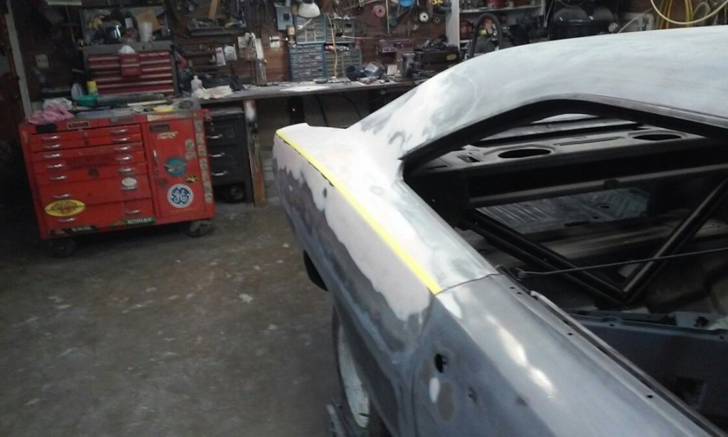

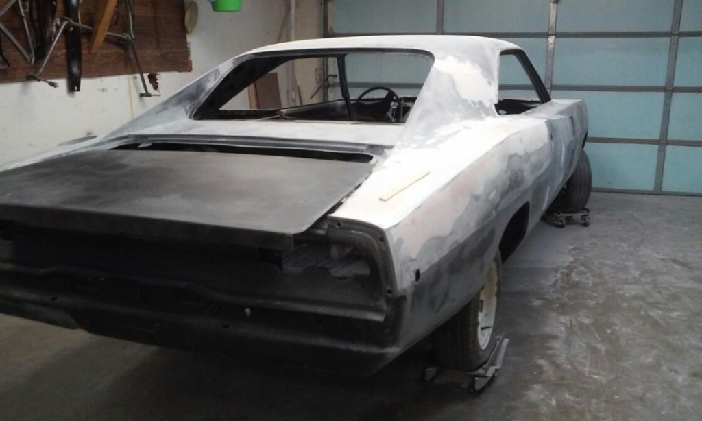

I've been getting a lot of work done. Still on hold with the painter. I'm about ready to find someone else. He's has strung me out way too long. But till I find another painter I'll keep plugging along. The right rear quarter was really lumpy so I've been smoothing it out. Also worked on the door gaps. I've got them straighter now but will adjust closer after motor and all else is installed in case they change.
Before
After
Either find someone else, or just do it yourself. If he's been putting you off to get it to him for 6 onths, it'll be that long or longer for him to do it probably. As much body works as you've done, you should be able to get a pretty good deal on it.
