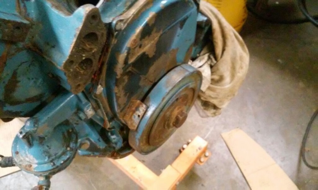

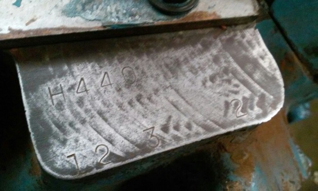

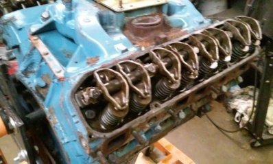

Picked up the 440 today. Went by the car wash on the way home and cleaned it up a little. Found out it is not an HP 440. Stamp says H 440, which means it was built in 1972, then below that it has 1 2 3 2. I think that means it was assembled Jan/23/72. It has some red sealant in spots so it has been apart before.

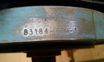

Can anyone confirm that the crank in this 72-440 is forged? Weren't the 440 cranks all forged around that year? There is a pic of the harmonic balancer and the part #, I thought. Isn't that the smaller balancer that comes on the forged crank?
Have the block sonic checked and magna fluxed to prevent wasting money on a block that isn't worth the effort. Just my 2cents worth.

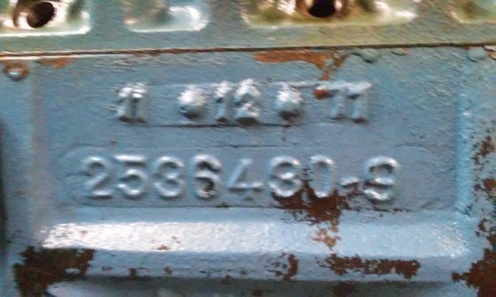

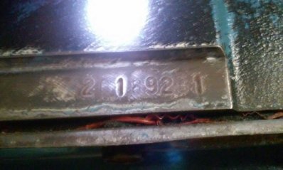

That looks like a Nov 12, 1977 casting date to me.
Yea it does kinda look more like a 7 than a 1 but I'm sure it is a 1 since the engine build date stamp is H, which is 1972. It was cast in Nov of 71 but assembled and stamped in early 72.
