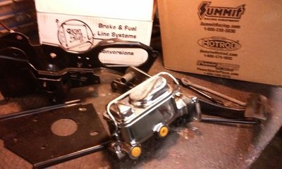

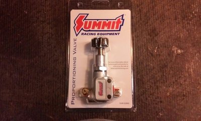

Got this the other day. Saw some good reviews on them. The master cylinder was backordered for a couple weeks.

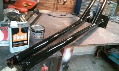

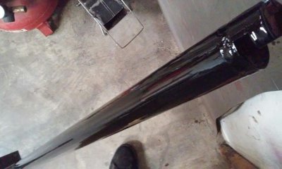

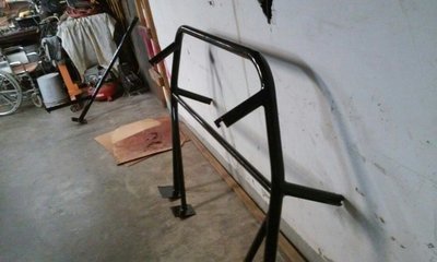

Finally painted the roll bar/s. Gave up on the hammered red and ended up gloss black oil based brush on, "the poor man's powder coat". Came out nice, but the secret is Penetrol mixed with the paint. It slows down the drying and keeps brush marks out.
20170727_180950_resized.jpg 20170727_181147_resized.jpg 20170727_072730_resized.jpg

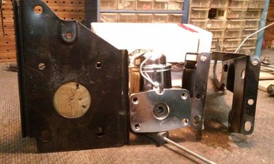

Got the master cylinder today. Looks great.. Now just gotta figure out how to put it and the pedal bracket stuff back together. Looks like I may have to drill some new holes first off. It had power drum brakes and now I'm going manual disc/drum. Any help and/or pics would really be appreciated.
Kid I did not have to drill any holes on mine.

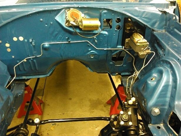

Hope this picture helps.
Yes it does, thanks.. And thanks for the tips on right stuff co... I have a big collection of pics for the brake and pedal install., I'll be looking at all I can get probably.
Not sure how much help these are. Also check out the Moparnation74, Justins thread 69 GTX for the love of my father. He has lots lots of good pic, tips.
Ok, now I see. I just need to egg out the big center hole and drill some new ones for the top bolts of the mc in the outer plate. I guess those are different on power and manual. Hoping to have a little time to work on it this weekend. Thanks , love pics of stuff I gotta do.

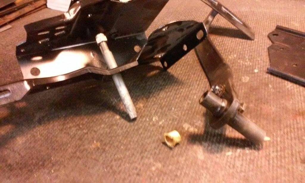

I'm trying to get my brake pedal in now and need some of these white plastic pivot shaft bushings. I could only find one of my old ones and it's not in to good of shape. Anyone know a good place to get those?

Somehow the other plastic bushing showed up, so I got the pedal attached to the bracket, now I need the push-rod like in the pic below that goes to the mc. I also cut out the big hole on the plate and used the piece I cut out to fill in the top of the hole and drilled the extra holes.

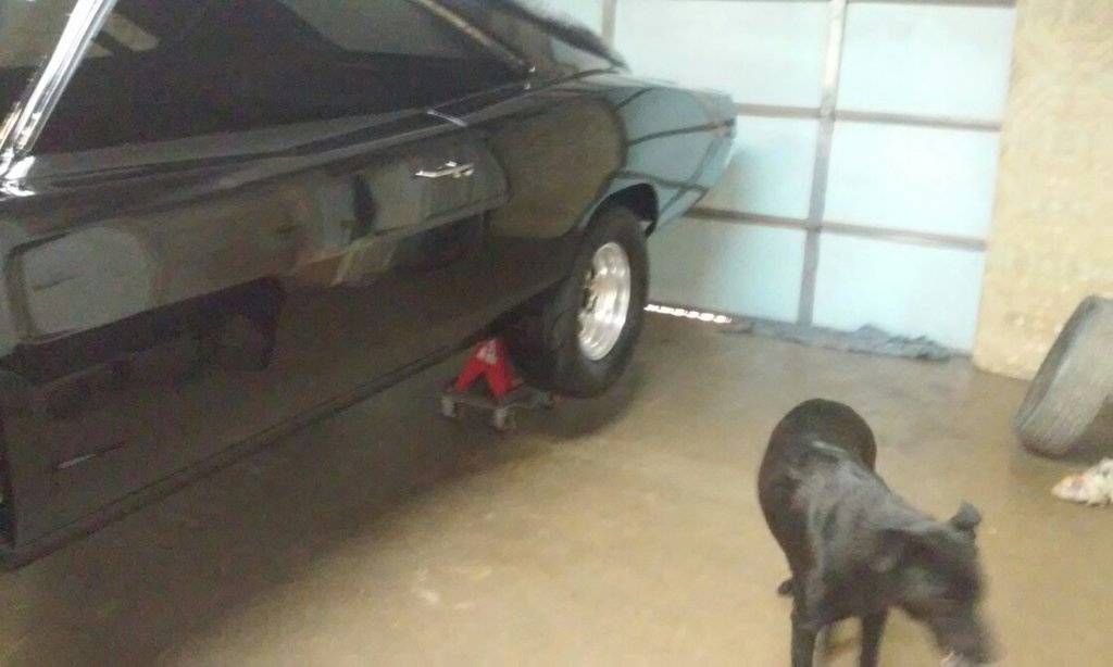

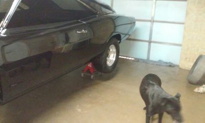

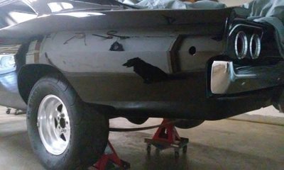

I borrowed a rear wheel and tire to help make sure I get the right size. This is a 275/60/15 tire on a 15x8 rim with a 3.5- 4" backspace. Lots of room left for bigger. I'm thinking, like some here have suggested, a 15x10 rim with 5 or 5.5, and 295/50 tire. The car should sit down another inch or two when finished I'd imagine.
