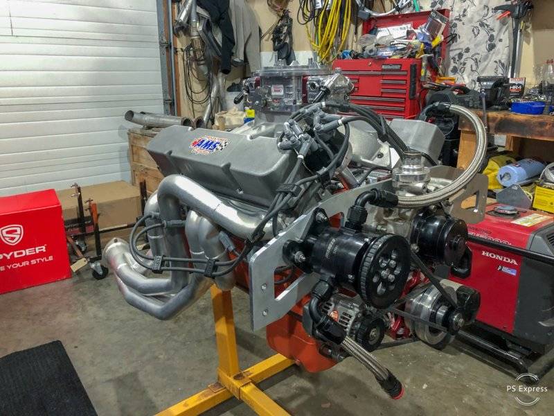

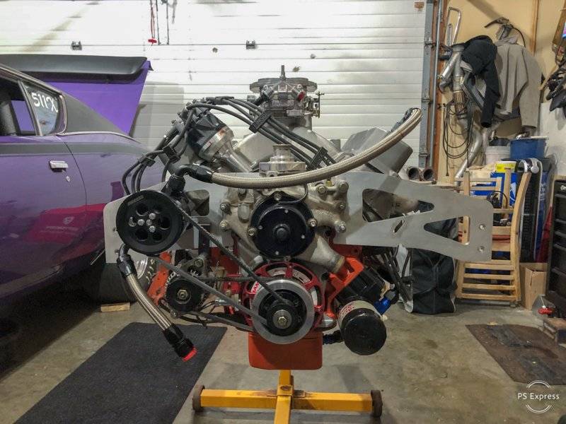

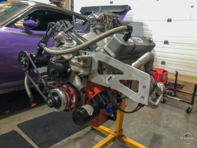

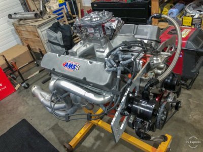

A few shots sitting on the engine stand. Test fitting some things before it goes in the car.
9A3731DE-FB82-490E-9AA9-7DF7EFDB5F53.jpeg 224AD52F-65E7-40E0-A6FC-AF1F5ACD4012.jpeg 005D97CD-9E97-472A-8E67-64A11395B8B4.jpeg 1720891C-3C57-4D2A-9DB4-A4634DED602E.jpeg
Lookin' sharp. The single line oiling won't try to suck the pan dry? Just curious
I was told that for the RPM I run a single line is perfectly fine.
Yeah I just have to change the end cap so it faces out the back. Coming out where it is will hit the rack. Have the cap. Just need to swap it out.
