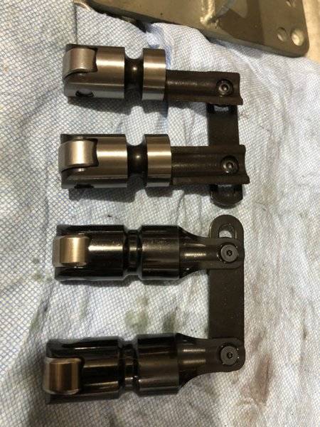

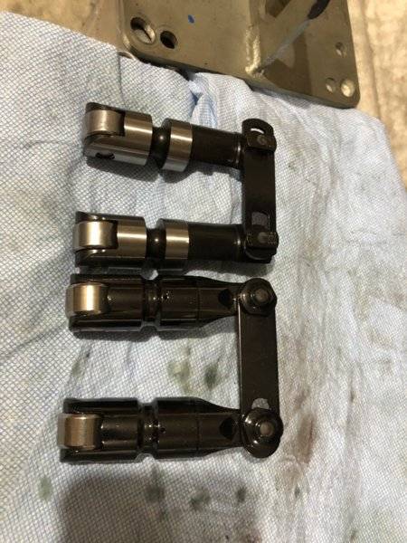

I also put a set of offset lifters in the motor to get the pushrod straighter on the intake side. Turns out my Jesel lifters have almost the same cup height as the offset Comp lifters I will now use. Pushrods will work fine. Only about a 1/2 turn difference between the 2. So that was a win.

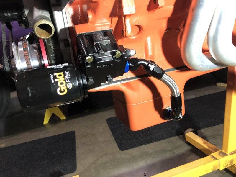

Also got the right end cap on the oil pump to clear the rack. Lots of room now.

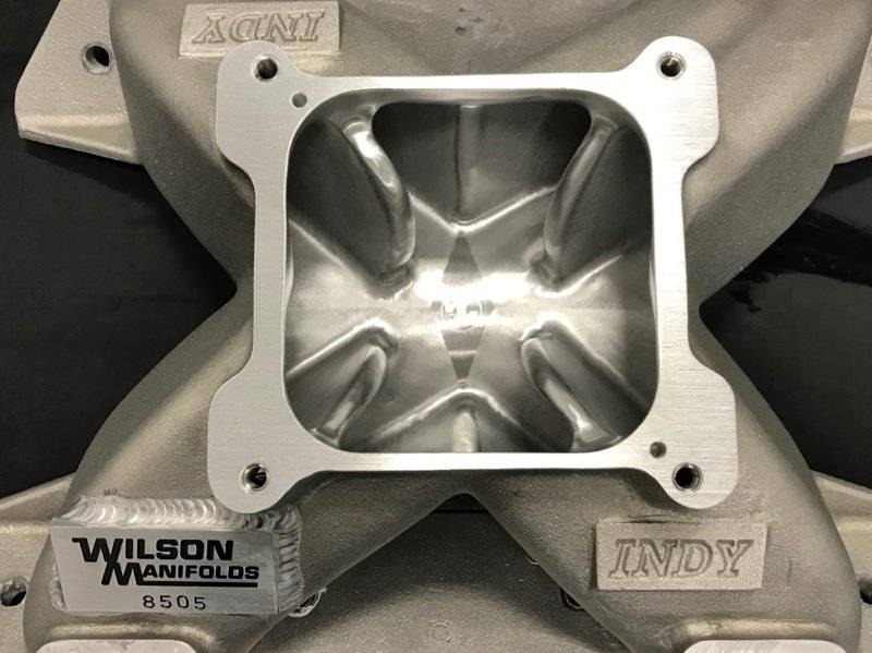

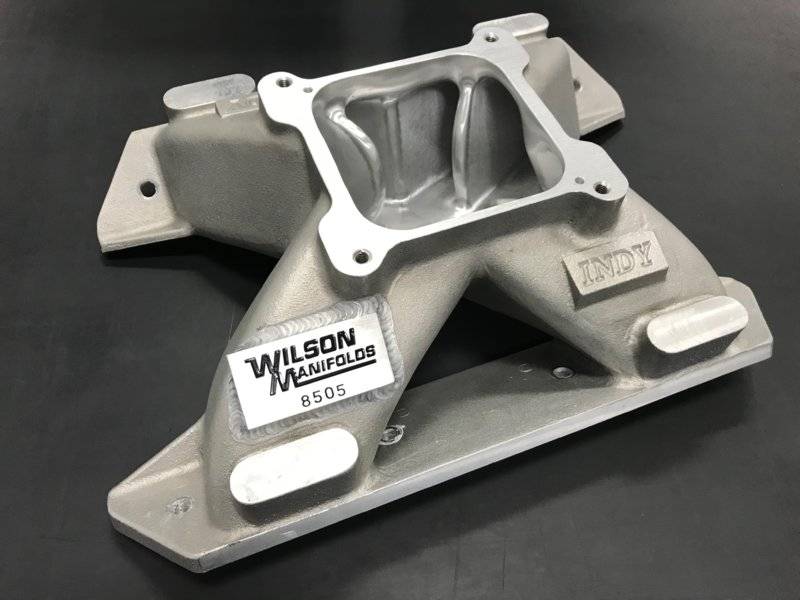

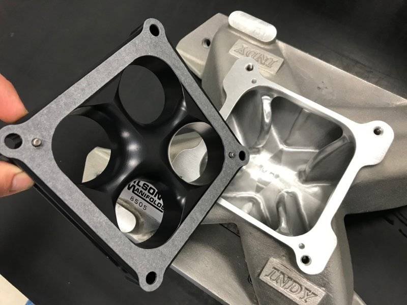

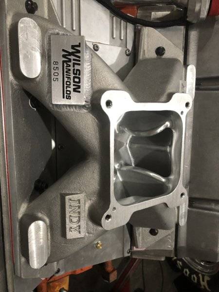

Wilson is supposed to have my manifold done by next weekend they tell me.
I’m curious to see what they all did to it.
I got a buddy with one of their ported manifolds and a billet elbow. I’m too poor for that kinda bling!!

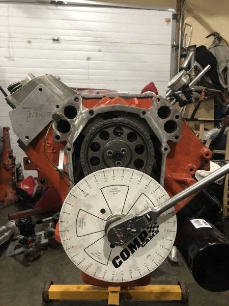

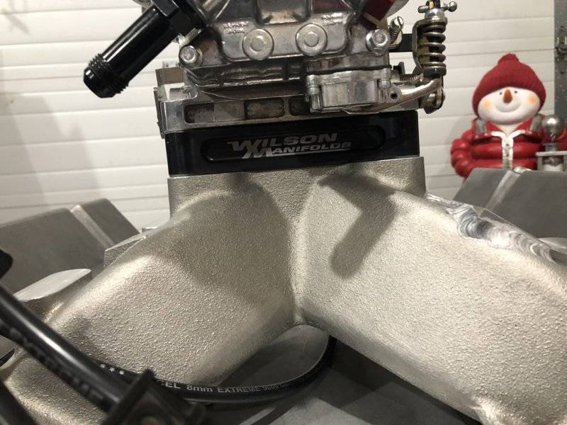

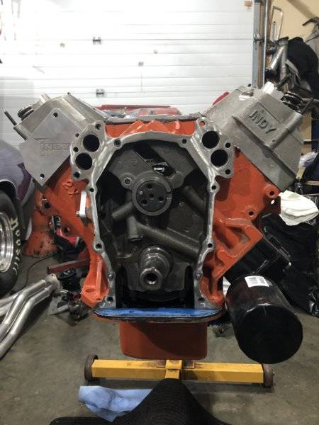

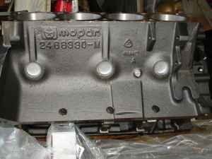

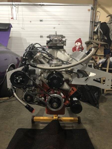

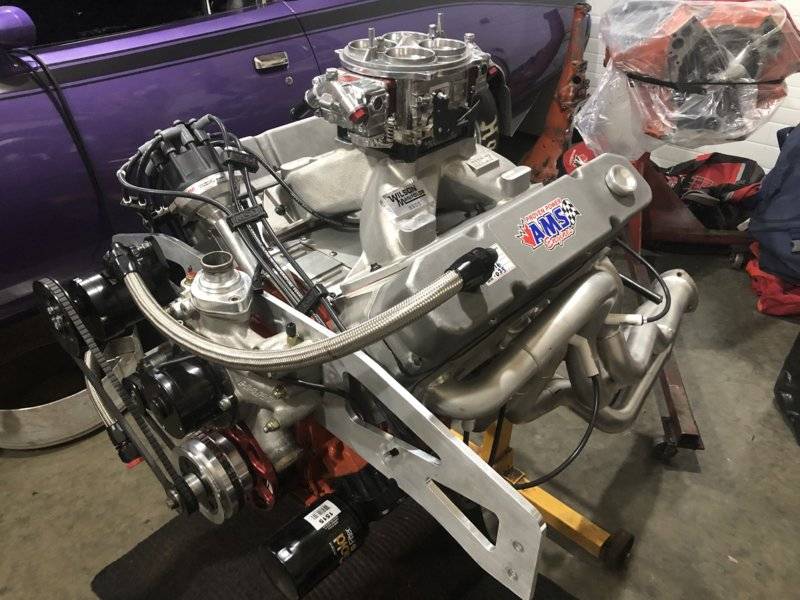

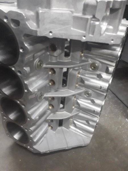

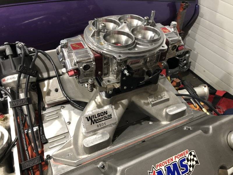

So sometimes dragging your feet pays off. Found a mega block, so decided that since the 440-1’s only have dyno time, I’ll save them for when I get this mega block together. So put the cam out of my 440 backup and the EZ heads on the 512.
Had this cam in the 512 before. The other EZ heads I had that cracked made 840 HP with this cam.
So hopefully with these EZ’s that are not ported as much and that Wilson Manifold, it will be close to 800. Not gonna dyno. Just gonna put it in the car and it runs what it runs.
Long day swapping over. I’m beat.

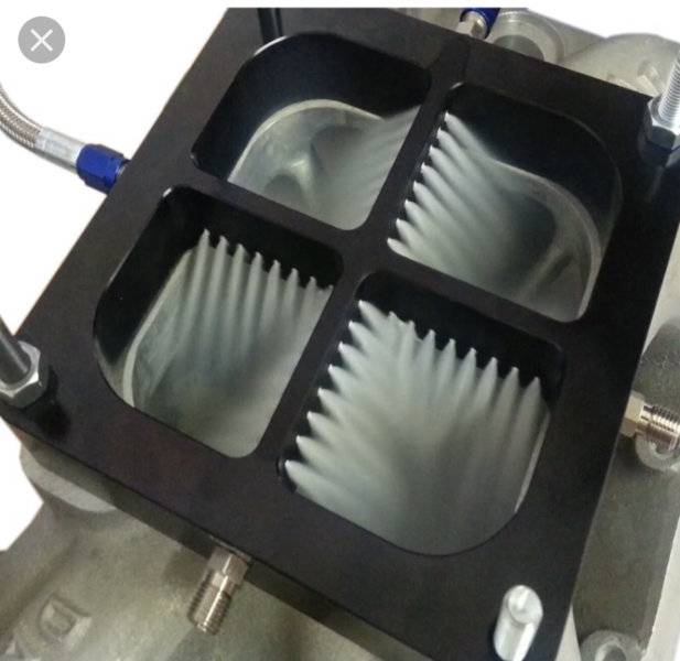

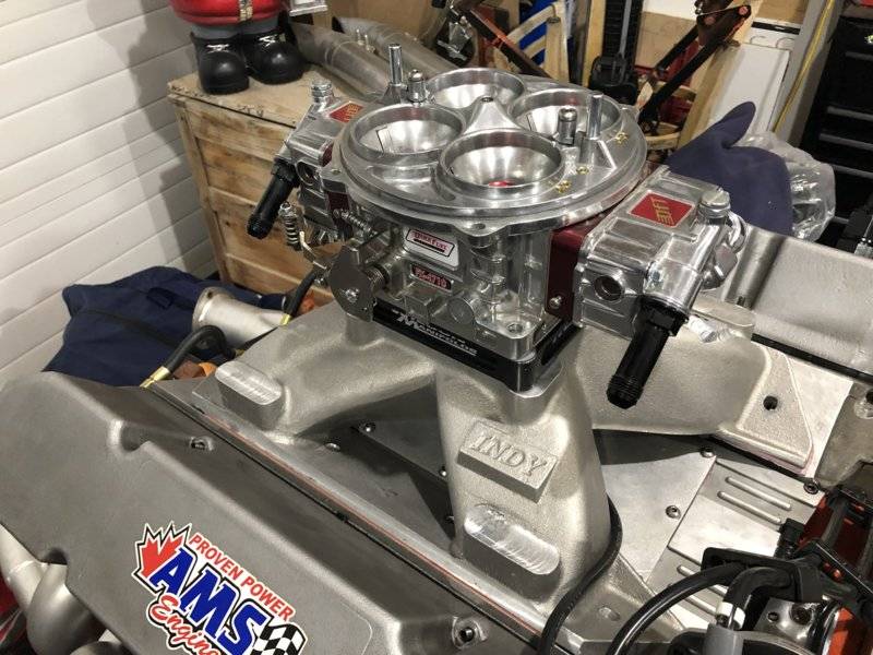

Just wondering is that wilsons plenum port and port match?
I have an intake I'm getting ready to send to them for the above. I went with the Super Victor vs the Indy. Gives me a tad more clearance with no drop off in performance.
