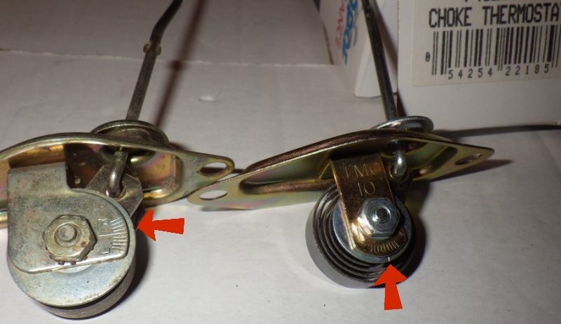

A couple chokes I have are adjustable (Lean/Rich). The one on the right is the MP. Other than that one could possibly add slight bend to shorten the rod to reduce closed tension.
