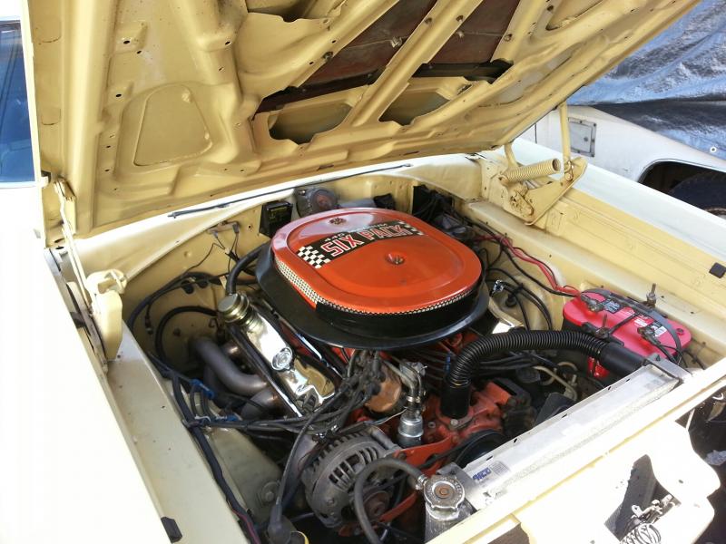

hello i been trying to adjust the mixture screws on my six pack on the center carb...the out boards are vacuum. i turn both screws all the way in and the motor doesn't 20140608_180042.jpgget-attachment.jpg934_p20_l (1).jpg stall? what am i missing here? any help on this would be great. ty in advance lol

seems to run ok i was just alarmed that seating the needles didnt kill the motor like every other holly ive adjusted. new to a six pack motor and a bit confused. was gonna turn em in till they started choking motor then back a quarter turn but alas no effect on the engine idle

UPDATE...i hooked vacume gage to the center carb and adjusted the needles in the meter block untill i was at max vacume at idle...was only able to acheive abot 12 and 5 inch at idle and it was jumping back and forth from 5 inch to about 2 lol....anyways took it out and it ran like a raped ape! still acts like it is missing at low idle cruising but i believe it is the cam...the cam is 509/292
The outboard carbs idle as well and that does have an affect. The mixture screws are capped off and are hard to get to unless you make a special tool. Six Packs are a PITA to work with!!!

How much timing do you have at idle? You should be at 20 btdc or more with that cam.
Use your vacuum gauge and adjust timing to highest vacuum then back off between 1 and 2 hg adjusting idle to 900 as you go, if it starts fine when hot your good to go.
By giving it more advance the idle will increase, then bring the idle back to 900.
By closing the throttle plates more it will bring you back into the idle circuit so you can properly adjust the idle mixture screws.
If you are in the idle circuit and you bottom out the mixture screws it should die or come close to dying.
