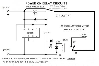

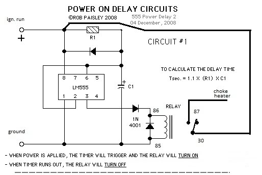

Am I missing something, or did anyone else find these links not helpful? There was no pictures of what was actually made, no schematics, and only one part number, the timer piece LM555. Anybody have better information on what was made? I would keen to make this modified choke for my Six Pack since I drive the car sometimes in the very cold NW Indiana.
Check out the link below,this guy installed a heating element by drilling a hole in the choke and going into the well and then installed a timer that runs off the ignition circuit so the heater turns off after a certain amount of time.
Check the second link it has schematics, maybe read everything before you say it wasn't helpful.
