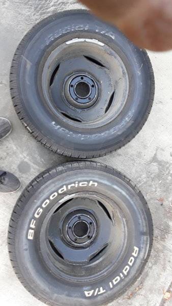

Will my 15 x 7 rims work on the front of 62 Dart and what size tire and not interfere with anything. They are Mopar cop wheels, not sure of backspace.

Thanks. Exactly what I am wondering. I put 235 x 70 on rear with these 7 in cop wheels, and have a pair of same I can use on front. The car currently has some 14 inch 75 series on front and they made me wonder if a 15 inch wheel would work. It is hard to measure with a tape!!!
Some rake is good with me. I will probably go with 215 or 225 x 70 up front> Thanks again.

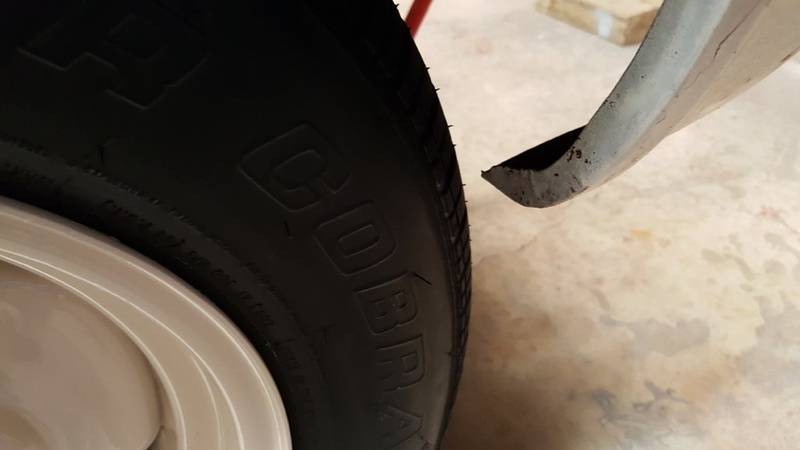

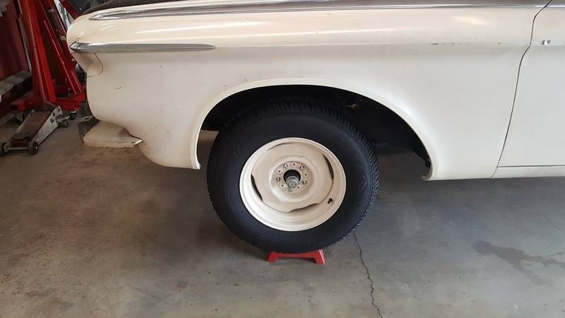

The wheels are a 4 1/4" backspace.
The fronts run real close to the front of the wheel well opening when the wheel is turned inward but have never made contact in the two years I've been driving it.
Wheels turned straight but are hanging, not on the ground.
