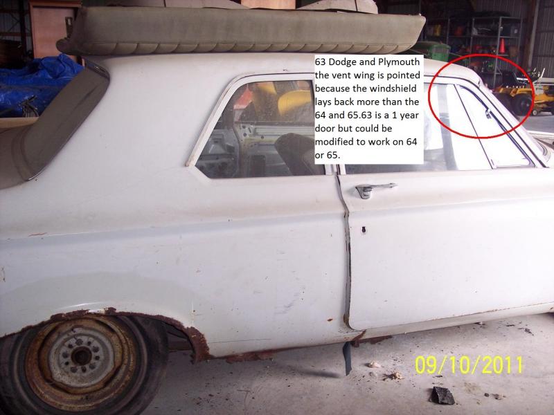

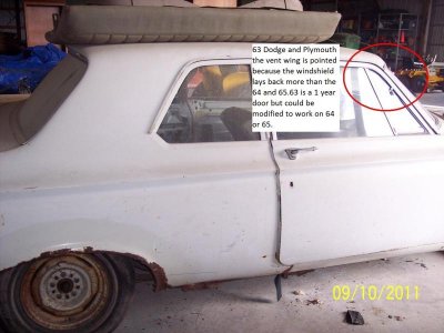

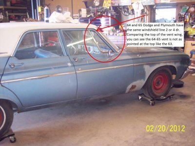

63-5 doors are the same. 62 are different.

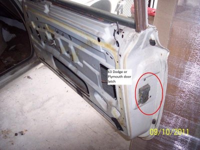

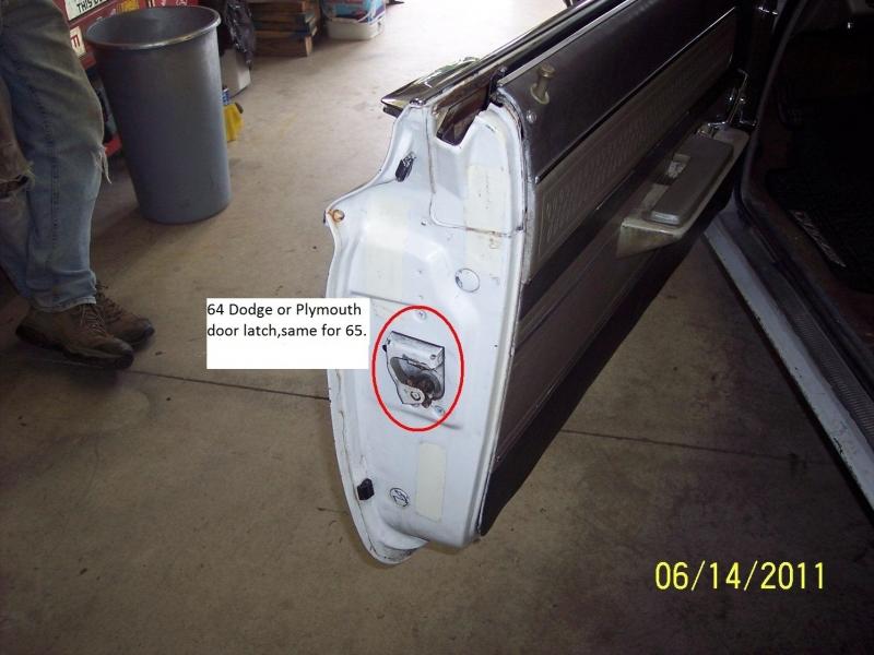

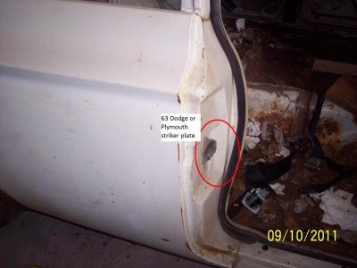

62 doors are 1 year only, the doors are the same Dodge and plymouth. 63 has a different door frame at the windshield than the 64 and 65's. Also the 63 door latches are different than the 64 and 65's.
Jeff

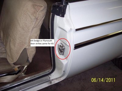

as i see the roof line looks to be a bit different on the 63 and 64-65 around the windshield , but does a 64 2 door will fit on a 63 ? or vice versa ?
Your question was answered above,the door shell alone will fit,the latch and vent window frame are different .
Doors
Here are some reference pictures.
Jeff
100_8559.jpgpictures 051.jpgpictures 053.jpgPicture 035.jpgPicture 037.jpgPicture 038.jpg
